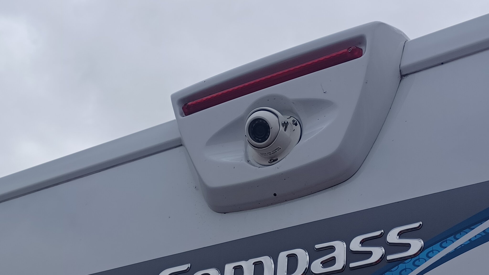

Thanks for the suggestion. At the moment I cannot get the camera out, I have removed the 3 screws, but it is either a very tight fit or has had sealant applied to it as well. I can see no sign of the cables inside they must go along the roof lining.
I don't really want to force it as the MH is less than 2 years old and still under warranty, probably not the camera though!
I have attached a picture of the camera, just in case anyone knows any more information.

Once the three screws are removed the unit will pull off. Its secured in place with clear silicone sealant there is also a large diameter washer..
The camera is attached with a coiled up cable that is long enough to pull out to check the connection tion which is a push fit with a threaded metallic ferule around it to hold it in place..Just give this a turn to make sure its tight.
I doubt it's this connection though as it is among way from the slammed door. There is probably a connection somewhere else near the door, that requires attention as it's a long cable .
I have a similar set up on my Eldiss but never had a blank blue screen. Mine started to ghost so bought a new camera of e bay £26, but when I took the old one off and cleaned the lens it cured the problem so now have a spare. (y)
