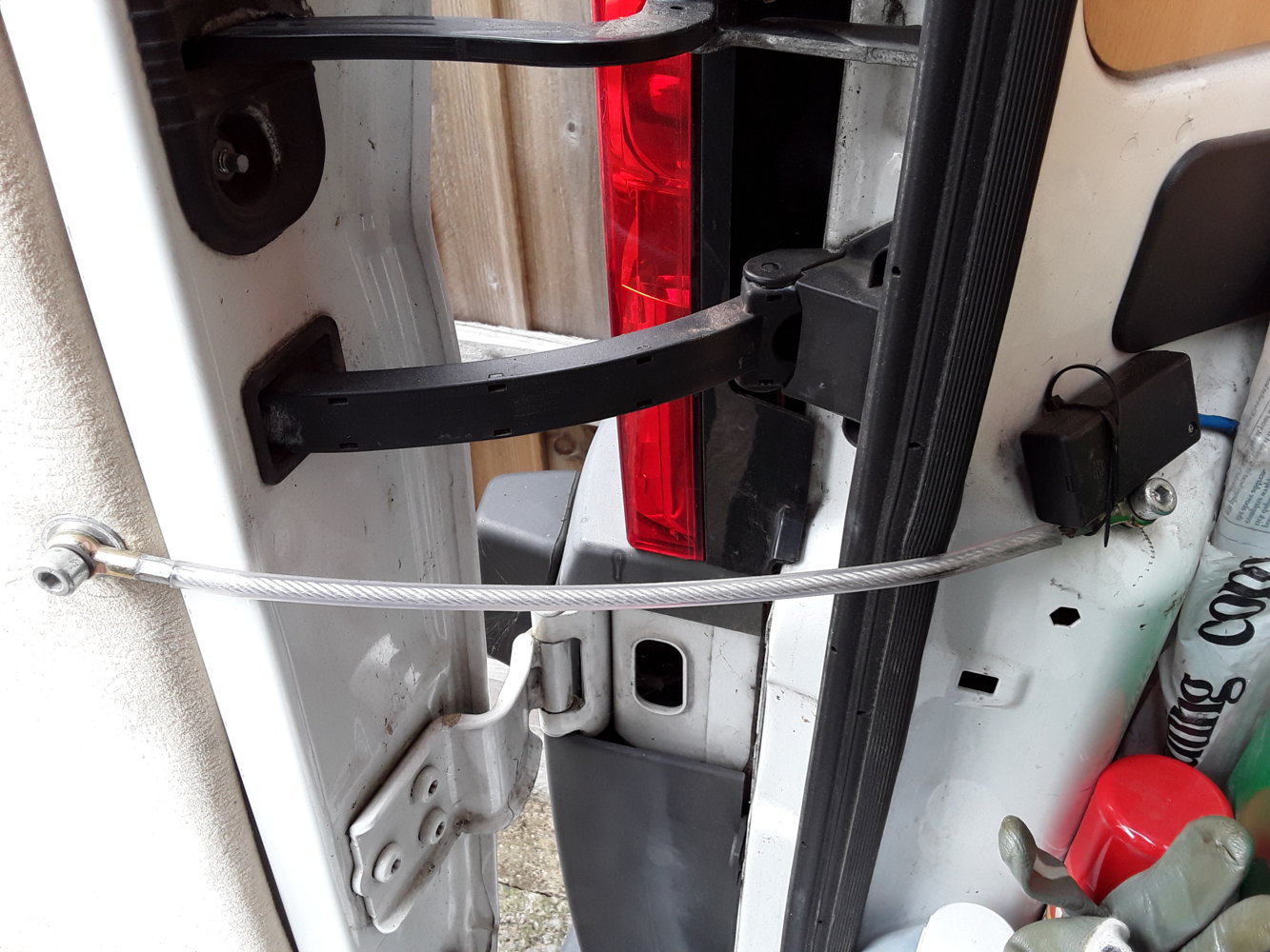

Steel rope on both rear doors on 2007 adria twin. Obviously dont want to spend extra nowadays.
