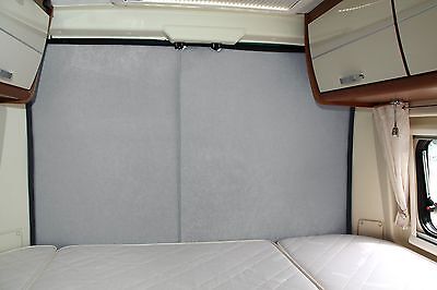

When we had our PVC we had a large insulated cover that clipped on to the inside of the back doors, similar to the windscreen covers but inside and it made a massive difference.
You can buy these now, fitted using magnets. £269.….
Ours wasn’t attached to the doors it was attached to the internal of the van with poppers, the bottom had two zips so you could access the garage area without exposing the inside. It came as part of the factory option winter kit.
