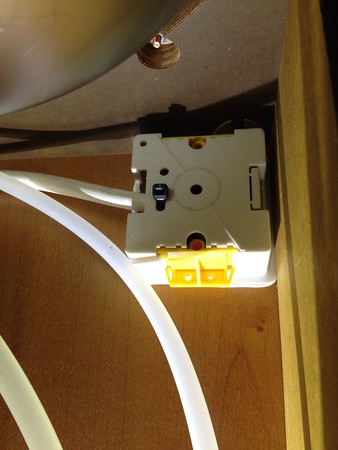

I just fitted one here too so wifey can sit on the bed to dry her hair. It's not possible standing up as she keeps clattering the ceiling. I had to pull a new cable for this as Rapido have taped cables together under the floor so I could not divert them.
Rear view top corner of under sink cabinet
