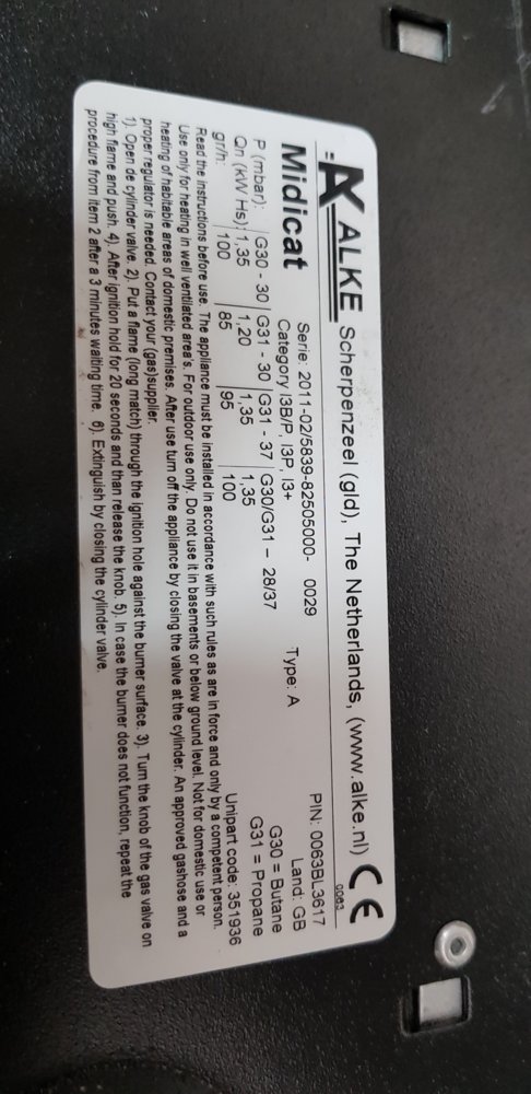

I have a Thermex for sale. £35 if anyone is interested.
4689DD34-9213-42B0-8117-96E50C775468.jpeg CB49DDF8-F263-496F-B5CD-19EF0411A616.jpeg
