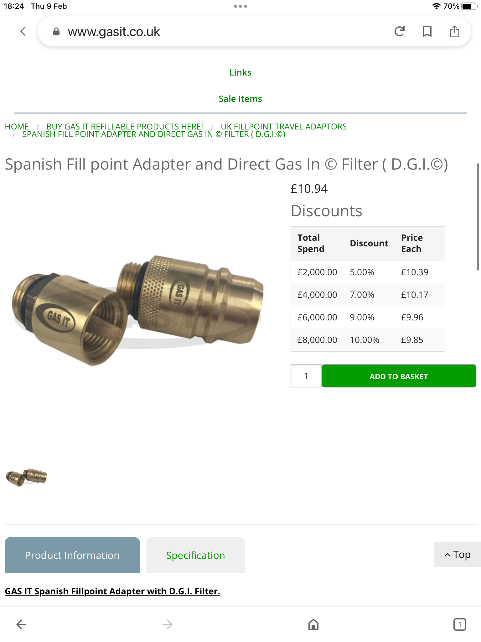

It would appear that the Gas It filter extension would solve the problem.
Now how to sort out getting one.

Sounds like you may need the straight extension and then the Spanish adapter on the end.

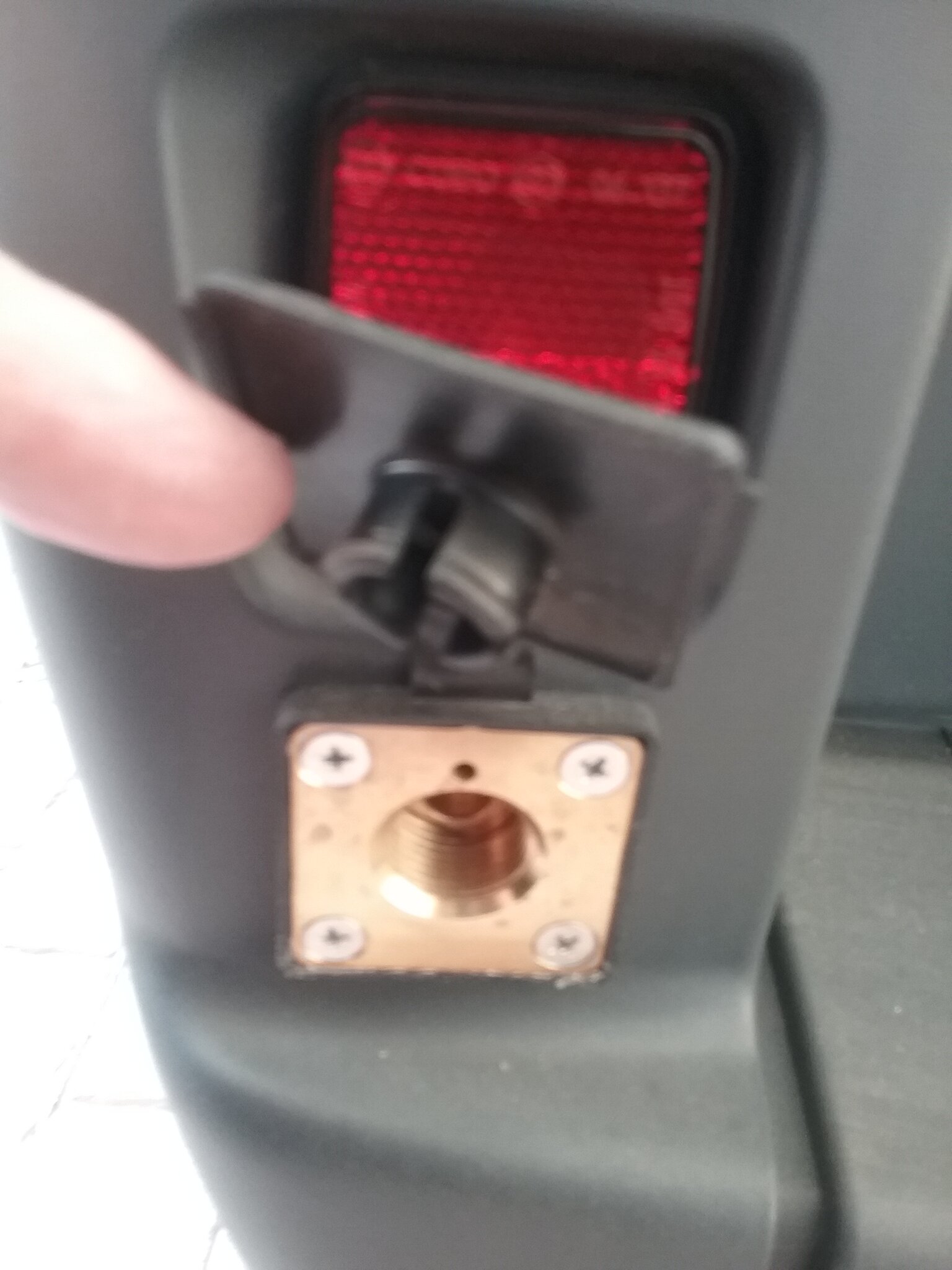

Yes standard UK external filler with bayonet fitting. The Spanish adaptor screws into this OK. The problem is the adaptor need to sit out slightly further, hence the need for an extension adaptor.
I would be interested to know if any others have experienced this problem.

Put a photo on of what you have Graham, because the same adaptors are available here in Spain, as in my previous post I had a thread put in, but most have a thread in them these days. 😁
We have gas it and have to screw adaptors into it, but if you put your UK on in, you should find its threaded inside and you can screw your Spanish euro adaptor into it. 😎 Bob.

You can screw a normal UK adaptor in then screw your Euro adaptor on. May have to saw the bayonet pegs off.
Probably get in Spain also known as a Dutch Bayonet.

Hi Bob , my filler is a UK bayonet with a threaded centre and the adaptor screws into it.
