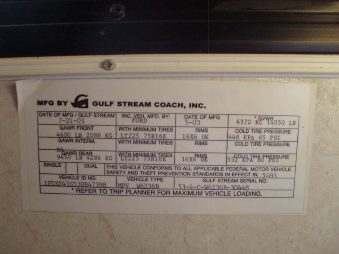

    Hi Folks
    There are three separate stickers inside the cab and habitation area of my mh that show the maximum gross weight as being 6372Kg.
    I remember getting an email from Gulfstream in response to a querie of mine, telling me that the vehicle weight when leaving the factory was 4500Kg.
    The V5C says: Revenue Weight, 4960 KG GROSS.
    When being UK registered the mh had to be taken to a DVLA station for inspection and so I assume that the DVLA Inspector saw the plated weights at that time.
    My question is. What happens if the police stop me and see the V5C Revenue Weight of 4960Kg, weigh my vehicle and find it to be 5432Kg which is within the vehicle plated weight.
    Essentially what do I do. Nothing or contact the DVLA to change my V5. I really don't want to get involved with the DVLA.
    Jim
    :Smile:

    Technically you are overweight.
    a personal visit to your local DVLA office with V5, photo's of the outside of the RV with reg plate showing and also of the 'plate' showing the true gross weight.
    in my opinion a personal visit is worth the effort so you don't get docs returned unprocessed due to missing or incorrect information.

    hi the max fine is 5,000 but could incur more if other offences were imposed . far better to have dvla look at the plates and get it up lifted .
    also you get a prohibition notice put on vehicle restricting its movements till its the correct weight. ignore it and get possibly another 5,000 fine.
    could only take a few minutes and your worries will be over.
    dvla at local level can be really helpfull.

    Revenue Weight is of interest to DVLA for establishing the Road Fund Licence fee payable. (Taxation class)
    MGW is of interest to VOSA and the Police.
    It is the maximum weight at which the vehicle is permitted to operate at. Maximum axle weights are also an issuewhere overloading is concerned.
    It is possible (more likely in fact) to be within MGW, but overloaded on a particular axle.
    What the converter's plates etc. say is irrelevant until those figures are quoted as MGW on the V5C.
    I agree with both PPJ and Alan. Despite what other plates on the van may say, you are up to £5k of overloaded.
    Follow their good advice and go seek advice from your local VRO.
    You'll find them very helpful, not like DVLA.
