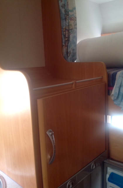

FullSizeRender.jpg Hi, thanks for all the helpful replies. Hopefully here's a picture of the space - it's not worksurface as such, and already has deep scratches as though the previous owners had something heavy up there.
Thinking about what we want to cook, mainly oven things like baked potatoes, oven chips - would be nice to be able to throw in a premade pasta bake or cottage pie on the first night too. Oh, and toast! So I don't think the micowave function is that important at all, I'm just worried about getting a wee oven that gets burning hot on the outside - doesn't seem to be a thing people complain about with combis (or not that I've seen, maybe they get really hot too?)
Maybe it's better to have something that travels in the garage and just gets lifted out when we get there instead of being fixed on, that way if I make the wrong choice it's easier to change it for something else!
