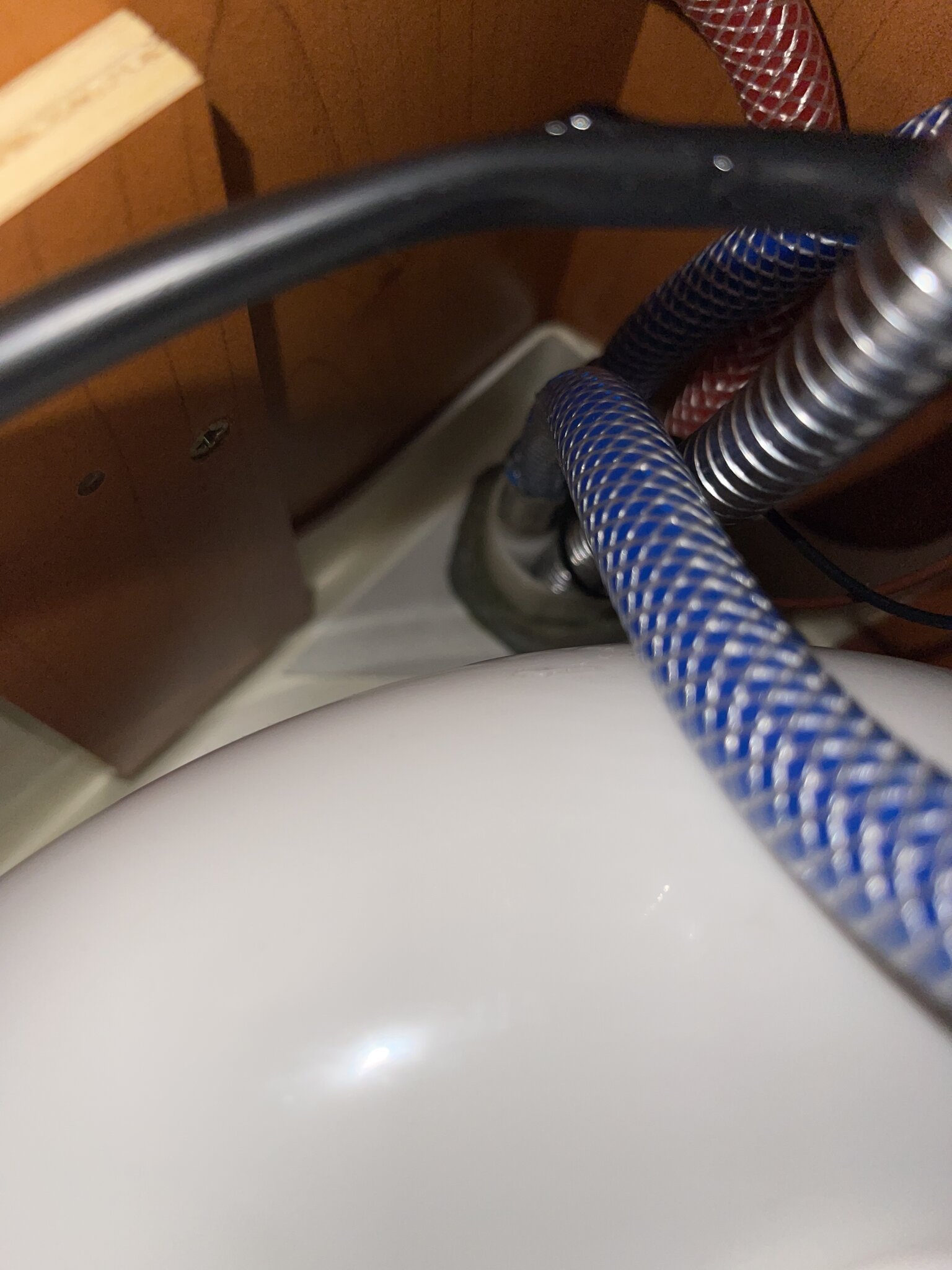

I have recently purchased a 2006 Arto and noticed a leak from the cold water feed to the bathroom sink tap.
Could someone tell me what the best way to access the tap is? I have unscrewed the wooden panel but this is still not sufficient.
Could someone also advise on what type of tap this is as I may have to replace it?
Many thanks in advance
Pierre

Thank for all your prompt and sage replies
I can now see the leak at the connection of a blue feeder pipe to the plastic part of the tap. I presume these are not the push fit types. It is very difficult to access to manoeuvre so I probably need to disconnect the drain and lift the sink.
I think the sink is held in position with 3 pieces of plywood?
