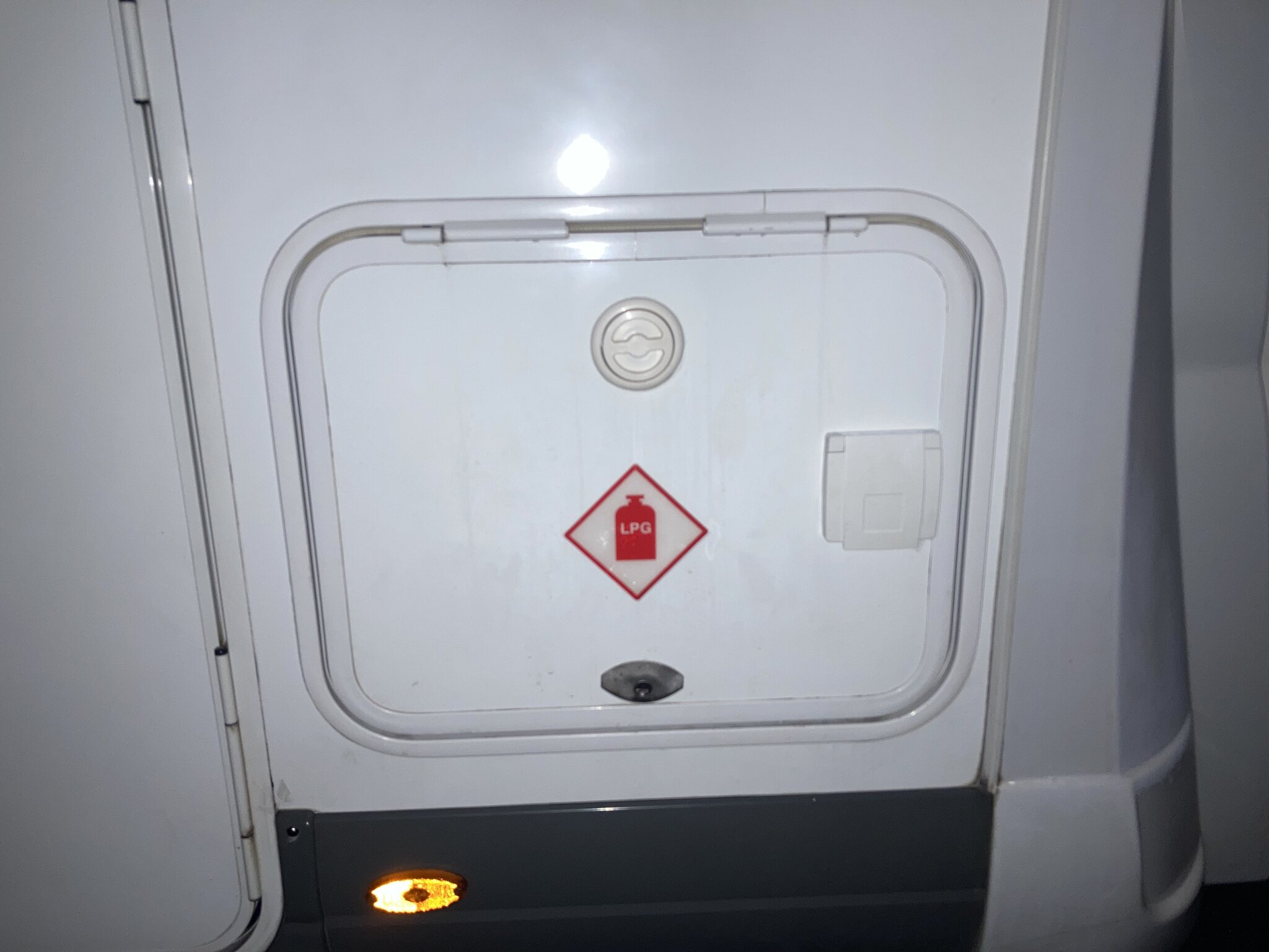

Hi, heavy on the questions tonight.
Does anyone know what I should be googling to find a replacement for this door or door & frame.
I’m not happy with the Gaslow install or the BBQ point and how they’ve been done. I’d like to replace the door and move both points into solid body work.
Mooveo C6

I think that you will very likely struggle to find one of the same design and size as it's likely produced for the van builder.
If you send your existing locker door to this company, then they will make one for you.

I think the door is made up from the panel removed and trimmed to fit. If it is, simply remove the infill panel, cover with a sheet of white laminate and rebuild. Obviously if you want to colour match the panel you would need paint or something.

That is probably the best option.

I like this idea, I’ll see how comes apart and get some sheet, or even vinyl to match after filling in the holes.

It’s a gas locker just replace the Gaslow filler point and Gas point with the appropriate size round vents 👍
