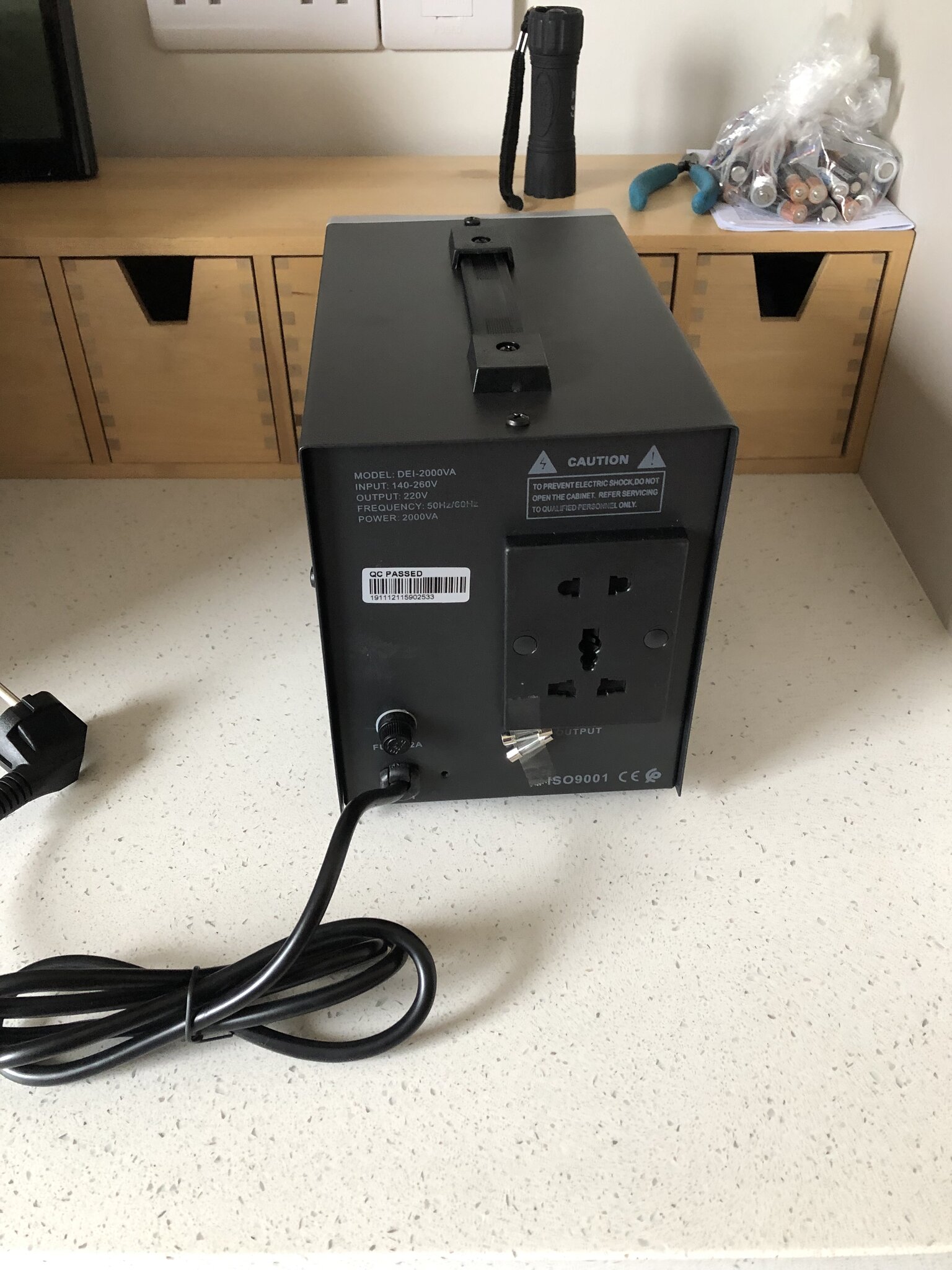

Sorry I don’t know what’s available. This is the one we bought last time we were in Maroc.
6DBFDEDB-9875-400A-8471-5871208B9DD2.jpeg E25DAEF5-D167-417D-B022-546F0A065898.jpeg 01F44992-F6F1-4D29-BED2-7E0387DDDE78.jpeg

The only place we needed to use it was at the campsite in Zagora. It was busy and I suspect the volt drop was due in part, to Motorhomers caning the rickety electrical infrastructure.
In fact Zagora is where we purchased the stabiliser. Lots of hardware type shops were selling them, which suggested there were problems in the locality.
