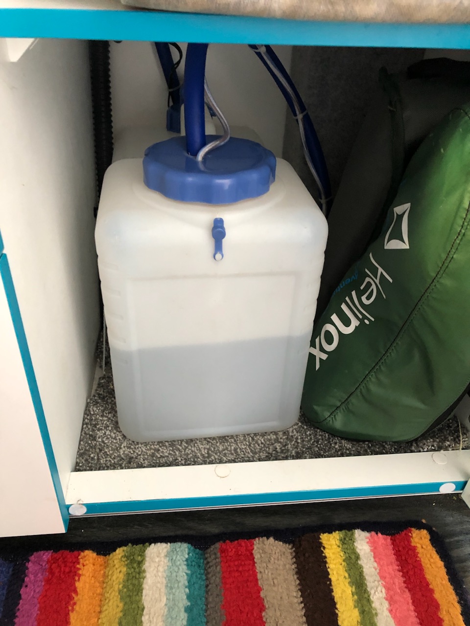

We have a 90L fresh tank underslung but I wouldn’t drink from that even with a filter.
So we also have a 15L container under the sink (ala Greg Virgoe) , it’s got a wide top and a submersible pump up to a separate tap.
The container is easily removable to be topped up by any drinking water tap, or bottled water if we ever find ourselves desperate.
Result - Always got fresh clean & cheap drinking water on tap.

This sentence concerns me ' The container is easily removable to be topped up by any drinking water tap ' 🤔
