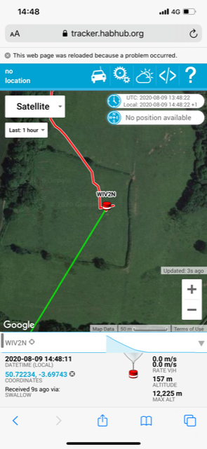

Once on the ground the icon changes again. The red line is the final part of the flight path. The 157m altitude is of course the height above sea level. :)

Because it was still transmitting on the ground it wasn't hard to find but even if we had lost contact with it we knew to within a field or two where to look as the landing site is predicted by the map. You can see this in the screenshot image above with the parachute icon. The landing site at this point was being predicted further north but as the balloon descended the system updated the prediction and eventually was almost spot on.
