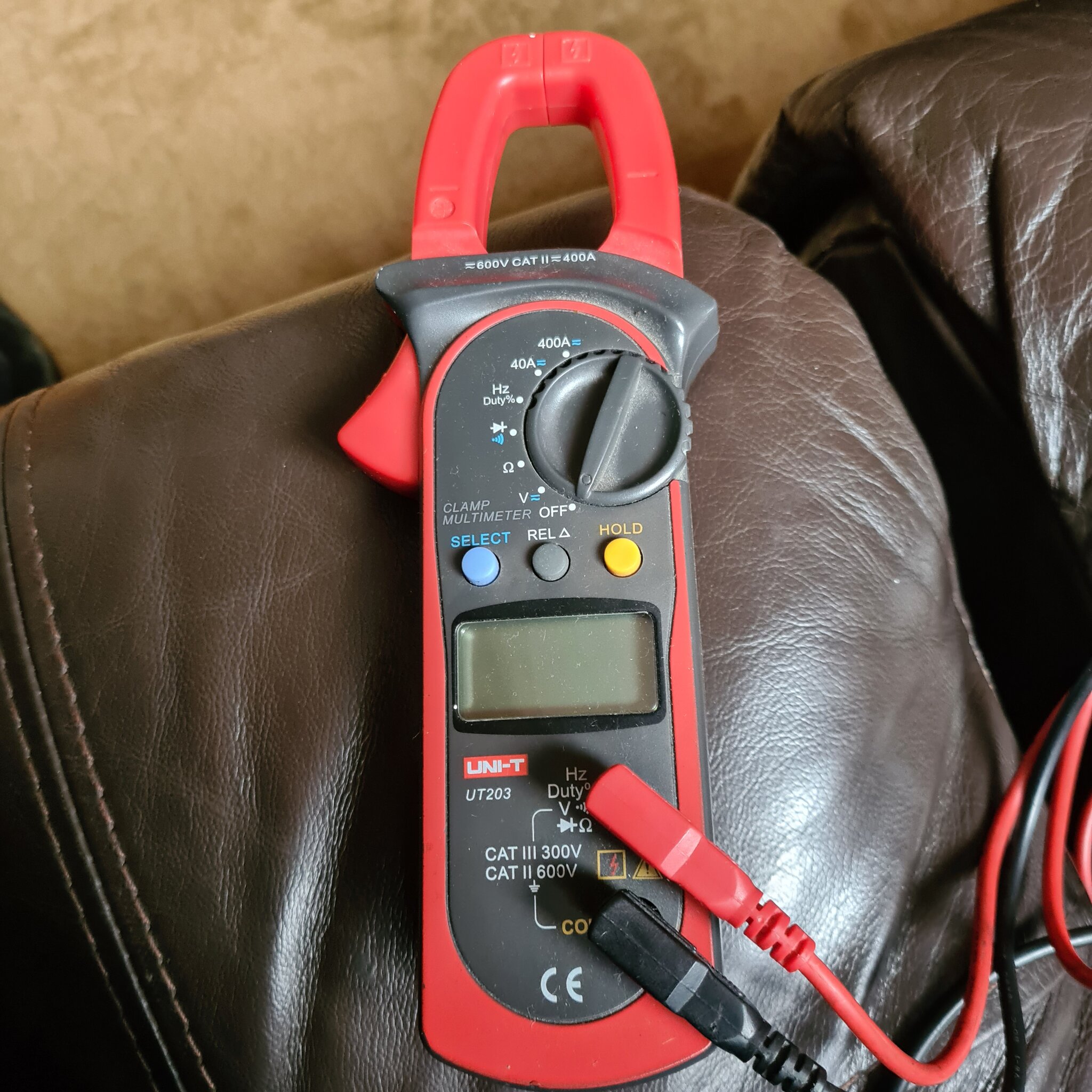

I'd look at getting an ac/dc clamp capable meter..makes current measurements that much easier..if you Google that and see what is available..the picture of mine was a popular buy some years back..not sure if the same one is still available..

I've got that one, It's ok but I bought the new version which is a bit better resolution, smaller and comes with a soft case.

I have the one in Richard n Ann's post #5, like many others - I have a few multimeters, but this the one I always keep in the motorhome. Mind you, I'm very tempted by the LIUMY Scope meter that Hoovie mentioned.
