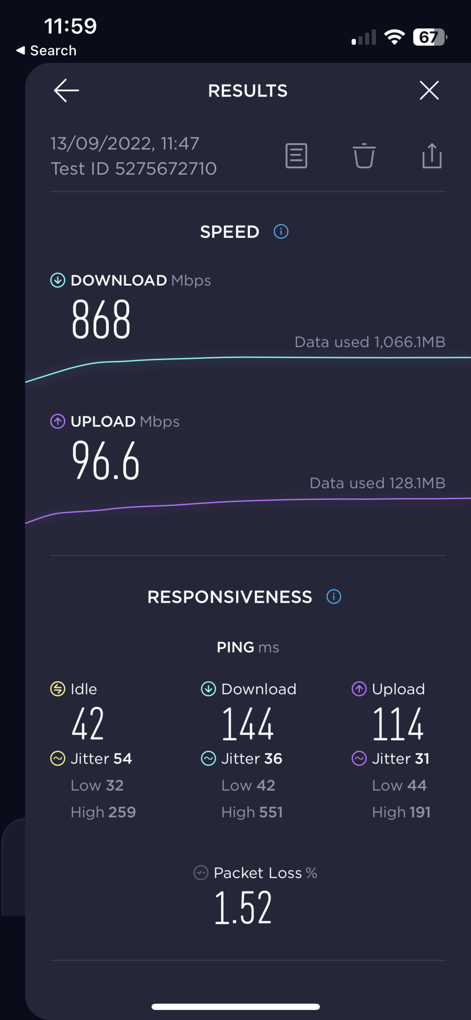

Not wholly the answer to the question but we have the BT Unbreakable package, so a Smart hub 2 and the Hybrid connect I have a Lan Cable to the wires office which goes in t a small switch from the switch to the Computer and another lan cable to the Hybrid Connect, if we were to loose the Broadband the Hub senses this and automatically switches over to the Hybrid connection.
So the question is could we go fully cellular, possibly but the BB still provides the most robust solution at 50Mps we can run zoom over the Cellular but wouldn't like to stress it much more particular as times when schools out or busy times at the weekend.
So from a business perspective it's £7 per month extra for the Hybrid box which from a business perspective makes sense from a belts and braces point of view.
