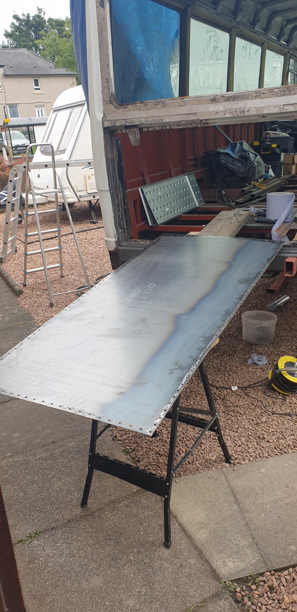

Tack a 'u' bolt on the inside middleish & use one of the inside roof supports to lift it with a thin rope or cord.
in fact tack a U bolt & a big bolt below it so if lifting it your self inside alone you have something to grab to help it up whilst tieing off. long a s you get it nearly there then you could screw it to get exact

Not criticizing but when doing plug welds (or whatever you choose to call them) the base area needs to have the paint removed to allow a proper weld, not just the hole in the plate.

Not a welder or a van converter but could you drill a hole in the van window area, centralish to where the plate is going, tack weld a bolt through the hole, hang the plate on the bolt so it can pivot so you can get it level and then tack in place
Does that make sense?

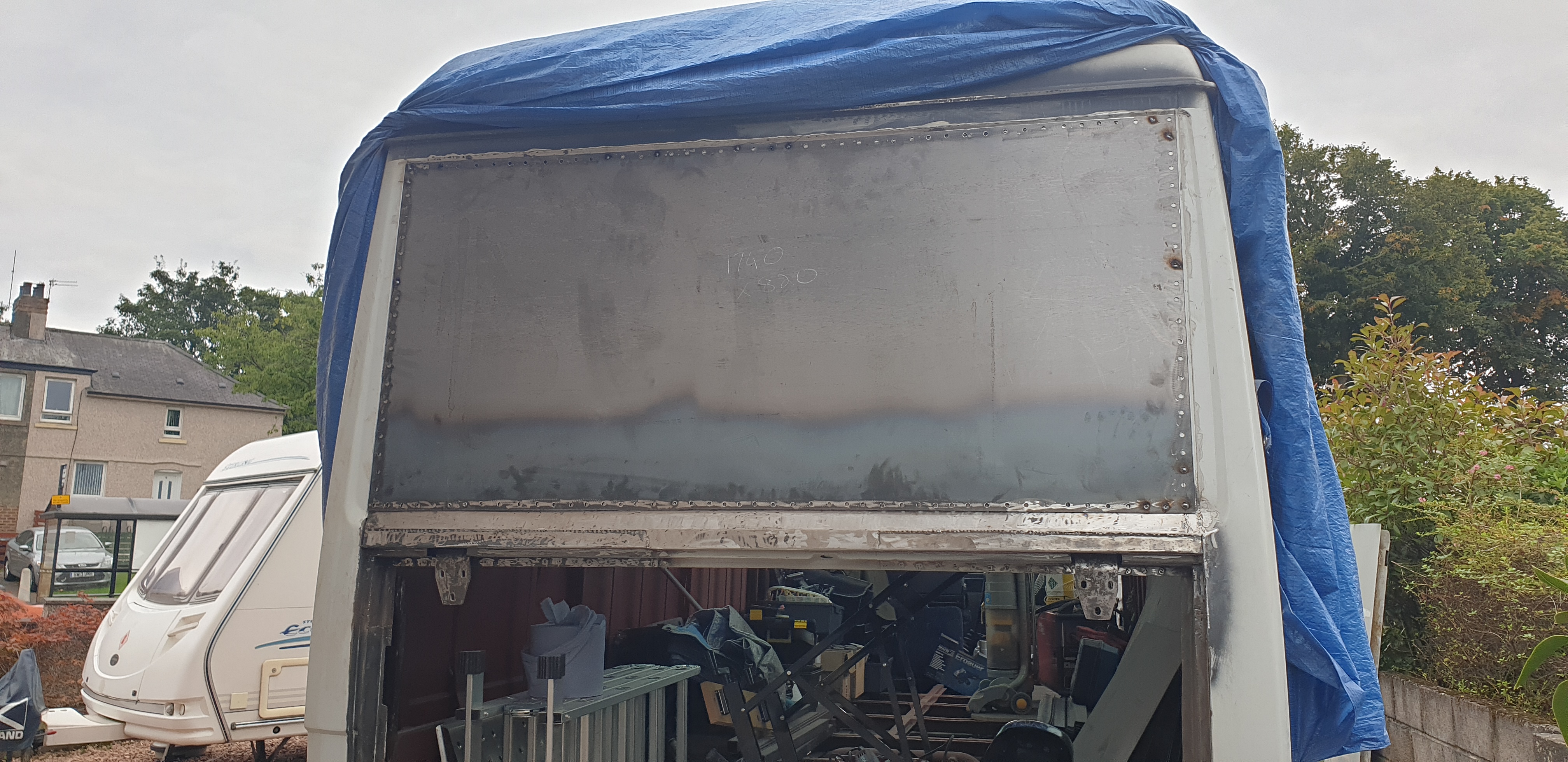

Panic over i went and asked one of my neighbours ...who was happy to lend a hand for 10 minutes so i have it up in place and a few puddle welds in to hold it for now and ill finish it off at my leisure tomorrow. That was the biggest panel so at least its up now ...but the neighbor scot has said hes happy to help with the others if i need it 😁
Looks quite good though it should look the part when finished.
Theres some rotten bits that ill need to cut out from around where the window was but ill get them from the inside when im adding welds to that ...

Are you going to weld a couple of uprights on that panel to stop any flexing?
I was just about to type similar.
I was thinking similar but maybe the kingspan or whatever that gets bonded to it should hopefully stop it flexing, a couple of diagonal creases folded into it would have helped, but wouldn't have looked too good unless you highlighted them like a Saltire !

Im at the stage now where i want to get this rear window panel welded in but i cant physically lift it up there and hold it in place to get a few tacks on it ☹️. ....View attachment 535952View attachment 535953
Little self tapper in the corners, then weld a few, take self tappers out and then weld those too, you really get very creative if you always work alone, I have done it for many years, but admittedly it is quicker to have a extra pair of hands!
Yes monzer folded 20 of them for me they will be welded to the frame but only glued to the metal sheet. Same as the originals
It was lifting it in to place that was the biggest problem but sorted now

Bit late now, but next time could you use those suction handle things that they use for carrying glass?
It's the size of the sheet that makes it difficult for one person to handle, 1740X820

I see you have welded it to the surround rather than to the lip the glass sat in. More sensible way as long as you seal the edges from water ingress. seam sealer?.
Yes taking it up to where the doors would have been had it had doors ..that way once its welded i can run a bead of sikalfex down that seam and it should look original. The top will be seam welded and then blended in with filler. The bottom edge spot welded then blended in to that edge . A few tacks here and there on the inside and sealed around with sikaflex ...2 vertical supports bonded on the inside and it should be quite solid.
It was more the weight and sheer size of the panel as it had to be centralised but couldn't see both sides from the middle

Are you able to put some cord through it and 'hoik' it up and tie it off so that it is supported whilst you get some tacks in then remove the cord?
Or, dare I suggest using the rope trick, which could get in the way if going around the sheet, a couple of magnets to hold it?
Sorry... wasn't clear, was I... my thinking was that once the panel had "handles" it could be hoisted/dangled/swung by them into position with some rope...
