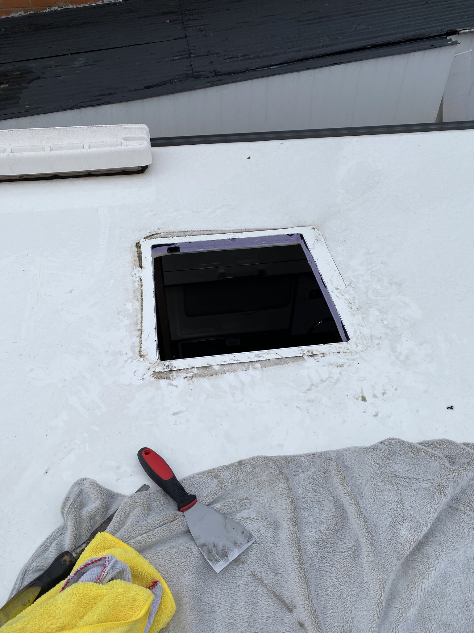

All fitted easier than I thought has anybody managed to adapted the original blind to fit.
kelv
kelv
Jun 23, 2014
665
881
leicester
32,091
Carthago 145
10

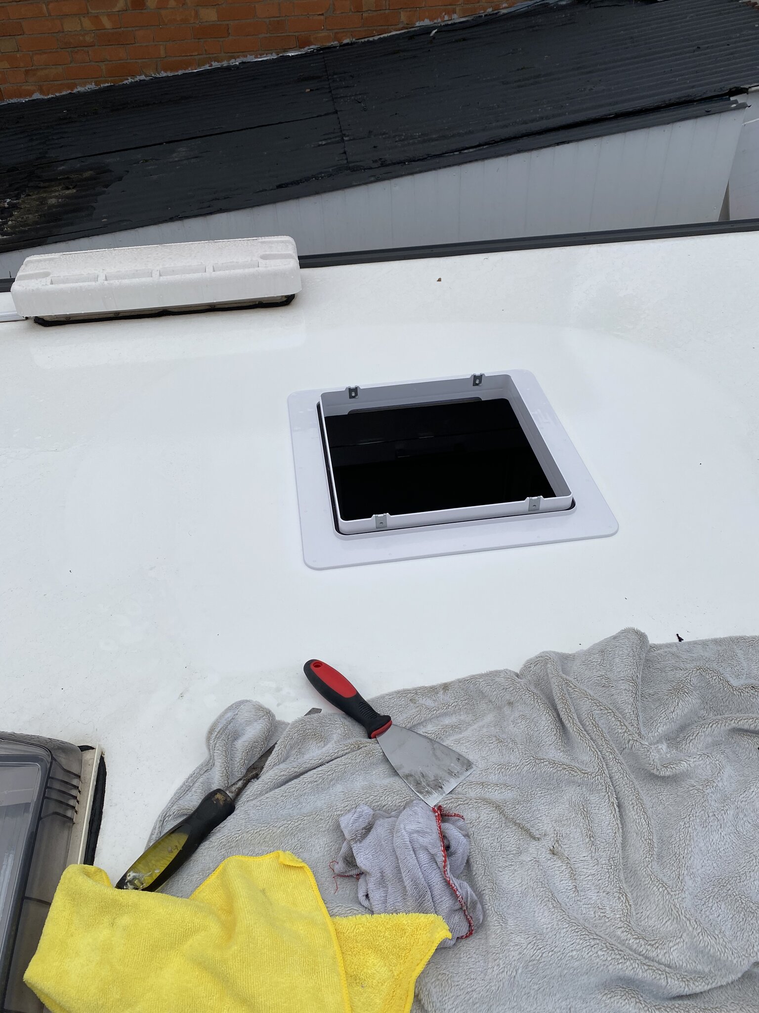

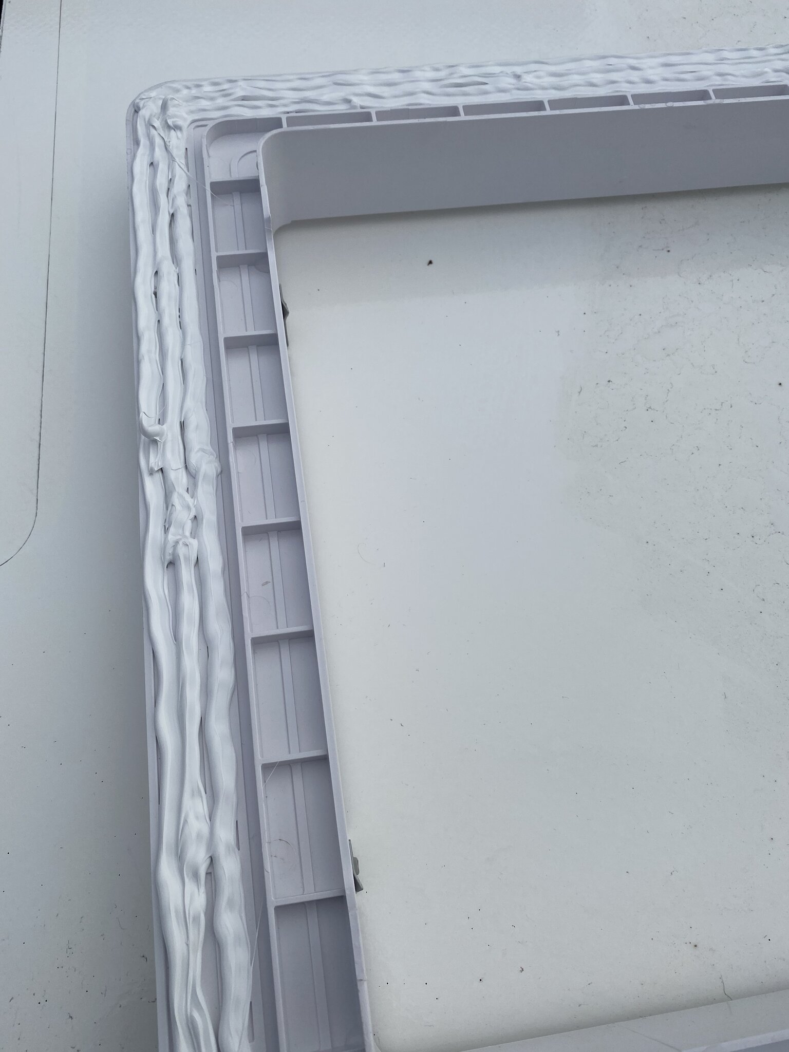

A fe pics of install

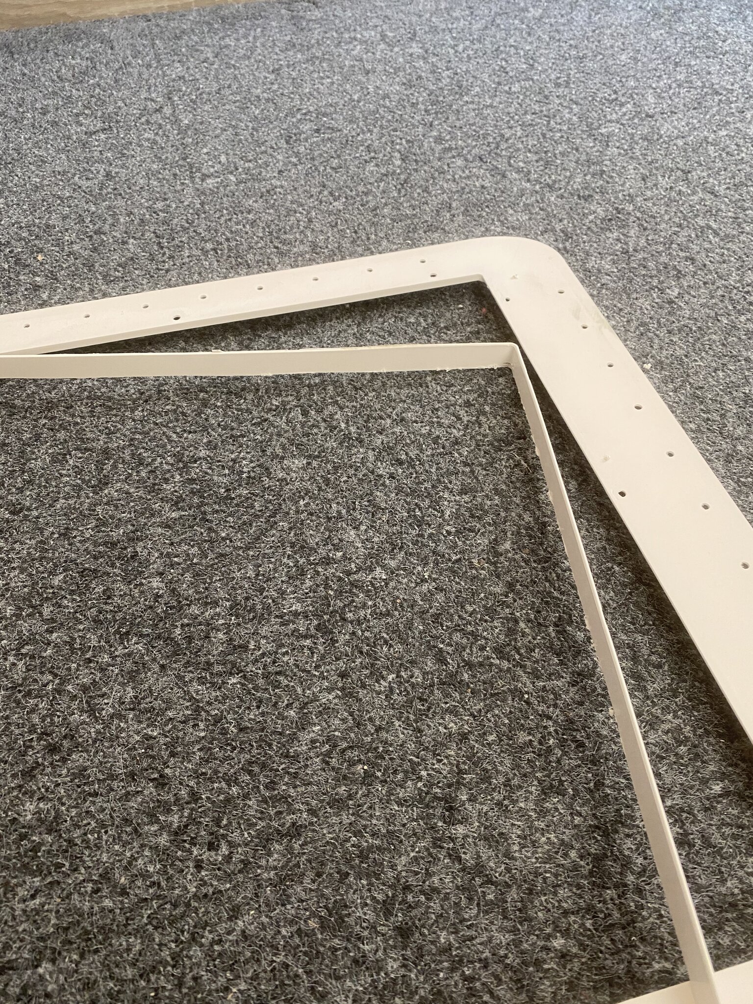

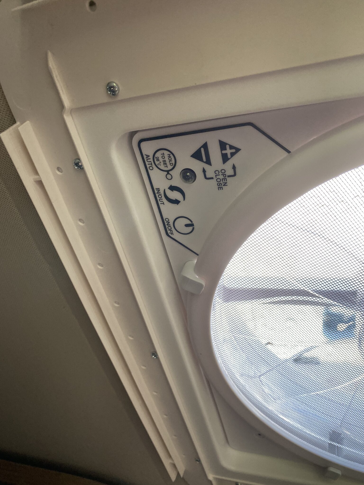

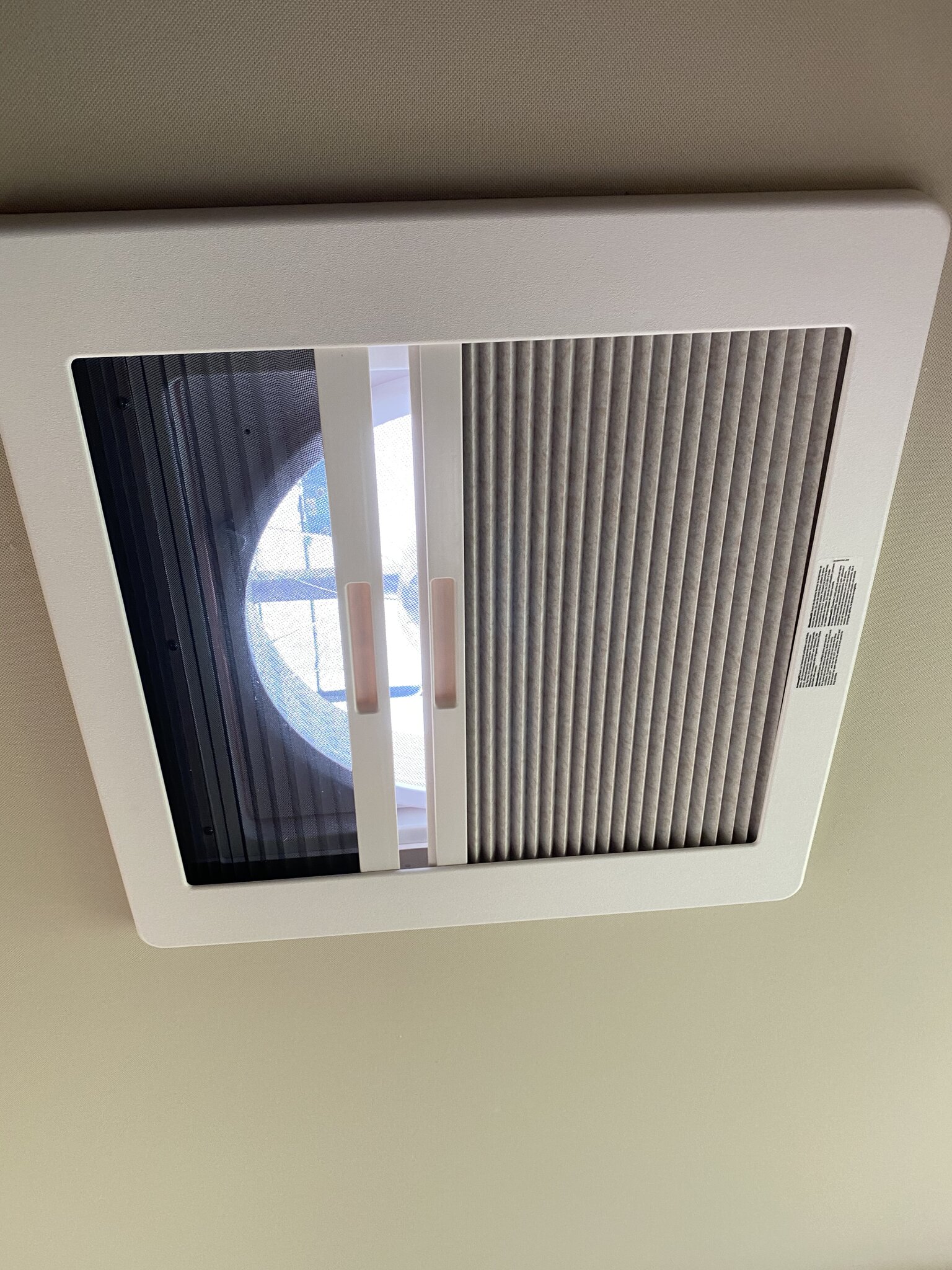

Adapted original blind a few pics for anyone wanting to do the same
wfdTamar
Dec 22, 2018
259
197
Tasmania, Australia (northern summer in Europe)
57,664
Hymer Classic B584
Since 2019
Couldn't quite work out how he did those strips, but applaud doing it that way. I've seen cheaper Fiamma skylights that have loads of screws around the top flange like these Maxair's have and it's messy and asking for leaks. So many holes and not necessary when clamp mounts work better. A bit surprised they use that method (screws).
