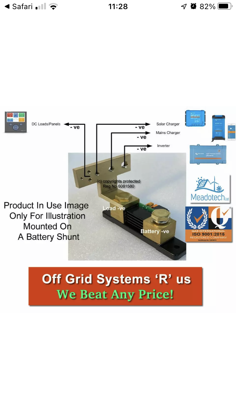

Just continuing the topic of busbars, what amp rating should I go for? I’m looking at adding a 2000w invertor or possibly even a Victron inverter/ charger at some point ( along with 200ah lithium) . What are thoughts on a brass plate busbar attaching directly to my Victron shunt? The installation area will be sealed under a screw down plywood cover so bare connections ought not to be an issue.
Brass or copper bar with brass bolts diy it’s not bad. You can buy copper bar 20x5 x150mm and just drill it to suit the bolts. Then get some m5-6 brass bolts and you got a nice solid distribution.
I suppose copper is better. I thought brass only because thats what the shunt seems to be made from.
Found this on fleabay. Its pricy but could be fabricated I am sure. The holes are threaded too.
Copper is a better conductor but it's very soft, won't make a strong thread for nuts and bolts etc., so brass is used instead for the hard parts like the ends of a shunt or the pins of a plug. Copper is fine if it's just being clamped.
If you use brass bolt and nut, you don’t need to tap any thread into the bar. I rather prefer nut than shallow bar thread on a mobile installation.
