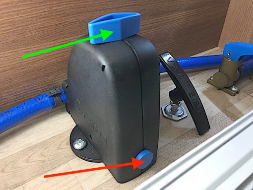

Do you have a boiler frost saver valve on the Tumer boiler?

Is it not the frost protection dump valve..?

According to the manual all it can be is that the water pressure is too high, maybe refill tomorrow with the taps open in case an airlock is causing it
