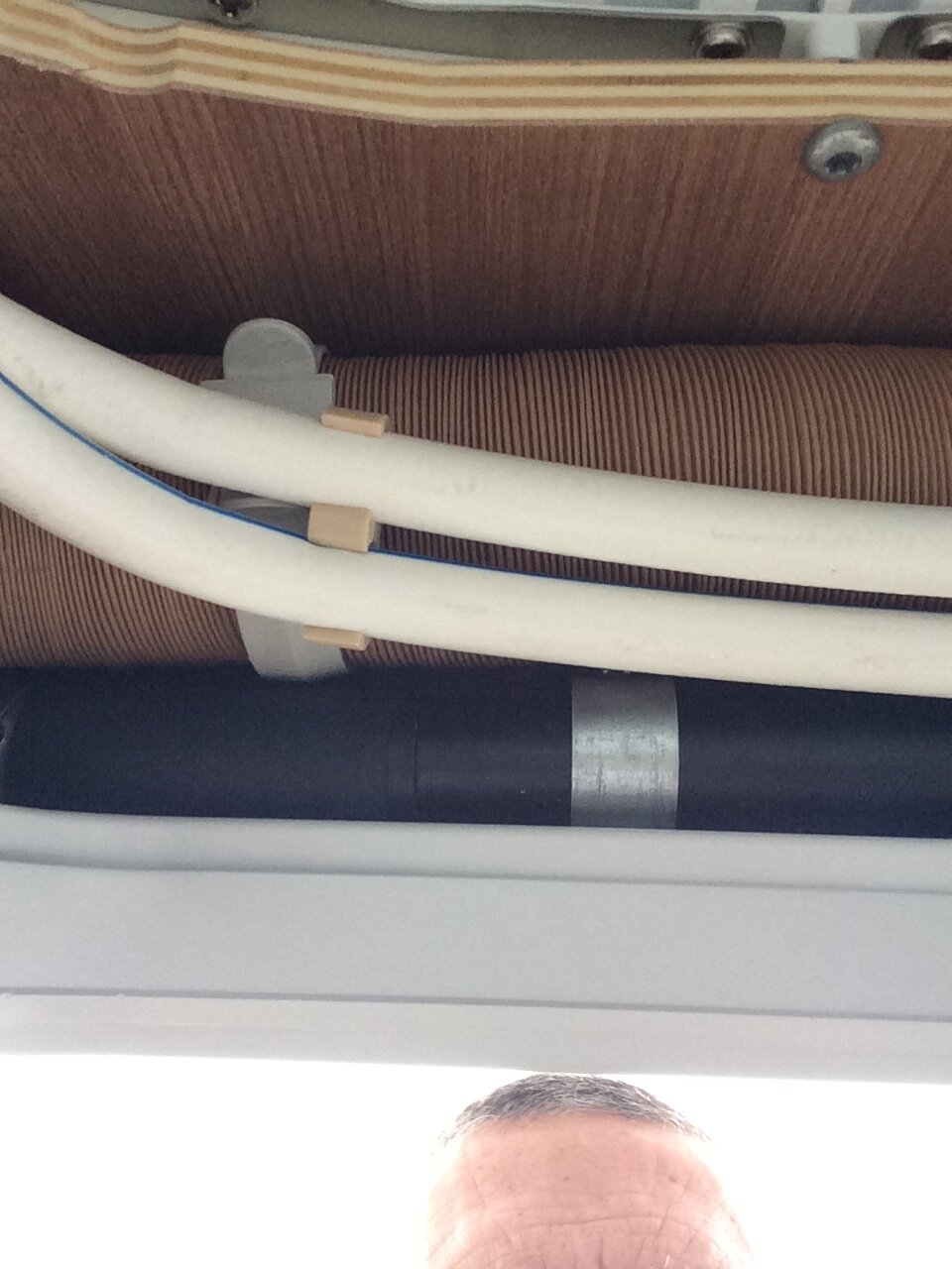

Hi mapman the video was really a god send. The pipe goes down into the toilet cassette cupboard and along the top above the door. and through into the space behind the back seat. Some of the pipe is rigid pipe with push fit fittings . BE careful they can come apart mine did behind the seat and when I tested the system the water drained onto the floor. you cannot see that joint unless you lift the seat to look in through) Hope you do not have to do this but it is doable .
Glad you got it sorted and thanks for the heads up on route of pipe work.
Got a couple of photos may help. One shows the pipe at the top of the toilet cassette door. The heating pipe and the water pipes come down to give better access. The second is the view under the seat, the wedge I glued in to stop the pipe moving back. Hope it helps
