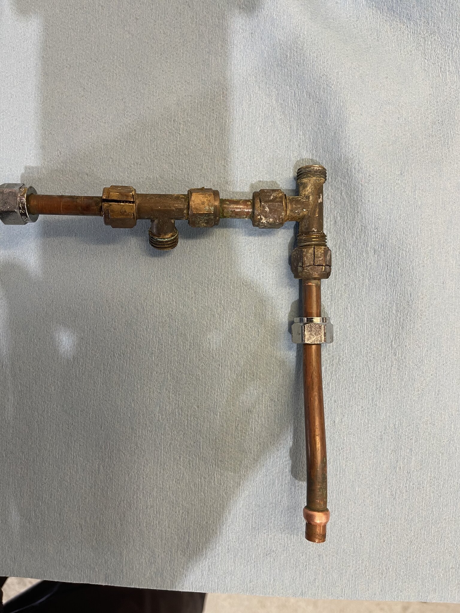

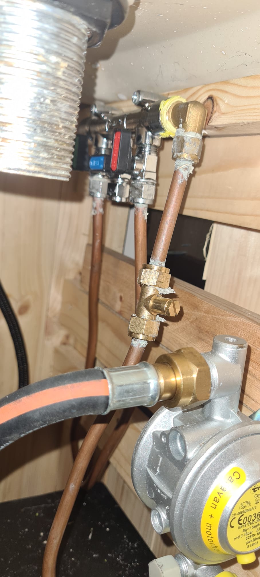

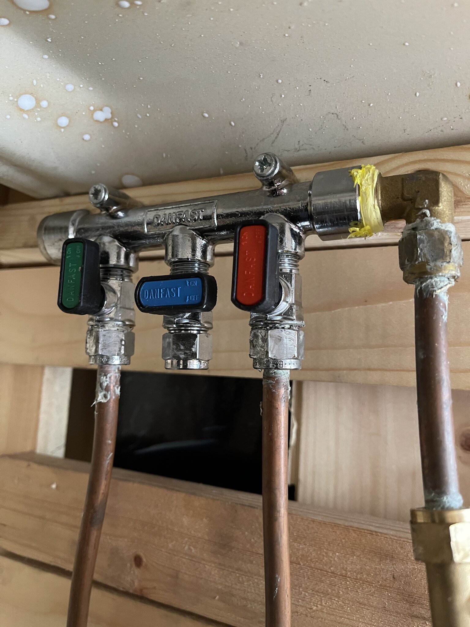

91CDD8A0-D74C-415D-8767-DB6B7C94085E.jpeg 9207862A-6AC4-4221-BCE8-E60684517E72.jpeg C9273931-F944-4B64-B4F2-477E96280297.jpeg 80EF834F-4F60-4DC8-8807-A2450F2C085C.jpeg 1ED41498-DB1A-4E6D-A9F5-E58ECEBD45E9.jpeg
We’ll hear goes , got home ready to tighten the offending gubbings 🙏🏼
