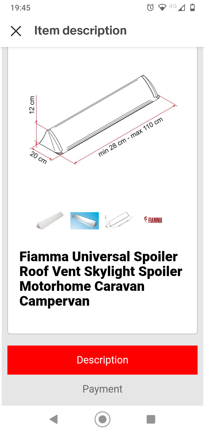

You of put one of these Fiamma spoilers along the front of it to help prevent air getting underneath and lifting it !
