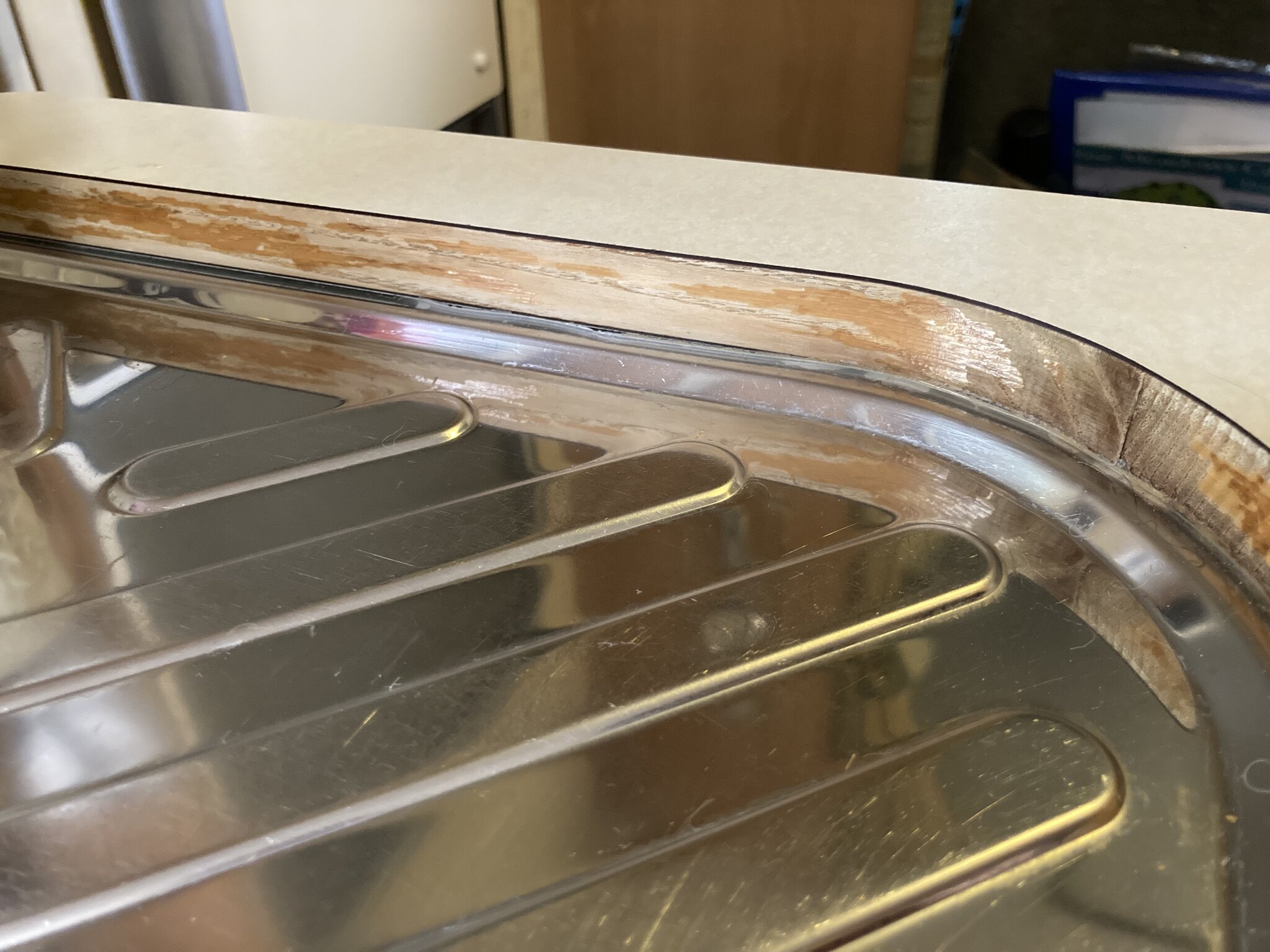

I look after most motorhome maintenance but mrskevemh thinks there’s some painting to do.
the first pic is showing the woodwork our sink is recessed into.
The second is our main table.
Both need some TLC
Maybe with a varnish coat.
But mrskeveh wonders if the sink area needs a specific product.
Does a product for that wet area exist?
If it was me I'd be fully sanding down the sink surround and, if you can't get the discolouration removed, fully treat with a single of coat of an appropriate coloured solvent based stain. Finish off with two \ three coats of satin yacht varnish. You could use gloss but it's (usually) very reflective.
For the table edging, and given you've got yacht varnish :whistle2:, fully scrape \ sand down and apply two \ three coats. No need to stain unless there is some discolouration that needs "hidden".
Just as an alternative, sanding will almost inevitably leave some marks on the sink, and the table top, you could mask the area's above and below then use a paint / varnish stripper, a bit messy, but easily wiped off. There are clear coats of resin based two part mixes on the market, more expensive, but harder wearing. Probably yacht varnish on there, so seems to have lasted quite a while.

I think the discolouration see is where the old finish has worn off.
Mrskevemh will be preparing the surface and painting with a yacht varnish 👍
I could be wrong (as usual!:RollEyes:) but I think you may find water has seeped into the joint in the timber and, possibly, discoloured it to a fair depth so surface sanding may not bring it back to the original bare timber colour hence the reason I said to use stain. If it does sand up OK just use the varnish as you say.(y)
No. Your feedback looks spot on.
Zooming into the pic, I see the joint area you describe.
Mrskevemh will have to adjust her fix for that area 👍

Sand it off and use Danish oil, it will waterproof the wood better than varnish and gives a matt finish. Just to warn you it will smell for a few days
You should use some Oxalic Acid after sanding to bleach out the stained /water marked wood
That is a good idea. I was trying to think of an oil or wax that would waterproof it.
And be careful how you dispose of the rags, Danish Oil is highly combustible ... (y)

Mounting a stainless steel sink underneath a laminate top with a timber core goes against all the kitchen fitting 'rules'. it exposes the timber to the water as in this example. Your lucky the water hasn't gotten under the laminate surface and caused it to lift. That type of top should really have the sink set in from above.

If it is a motorhome worktop it is probably two sheets of Formica separated by some corrugated cardboard and edged. That is why dropping a plate or something on it makes a hole
+1 for Danish Oil. We got a walnut worktop in the van, finished with danish oil. Same for the bed/ sofa side. It takes some beating. Over 2 years and still looking as original. You can re fresh with a light sanding and a reapplication of oil at any time.
