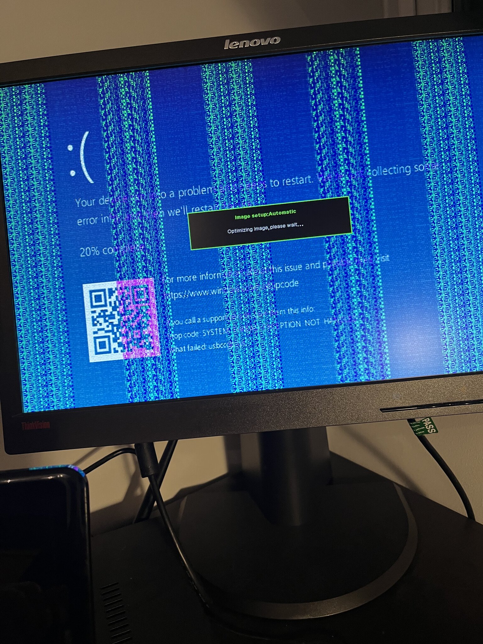

Just connected to an external vdu and got this ..,
From the little I am able to read it seems like a window’s failure
But I really don’t know

I hope I don’t add confusion but from the screen shot of the Windows error message it looks like a couple of things are going on.
Windows won’t boot normally but it’s “well enough” to tell you that. That means a fix could be simple if you’ve windows recovery media, etc. yy
Boot you’ve a graphic display issue that looks hardware related. (n)
The ”optimising image, please wait” middle message is from your monitor.
If you’re backups of data and are looking to get a new laptop, one of the SSD/HDD sata to usb cables could be used with the old laptop’s SSD to speed up copying across data to a new PC.
That new laptop idea maybe easier than troubleshooting the combined OS & HW issues on the old one
