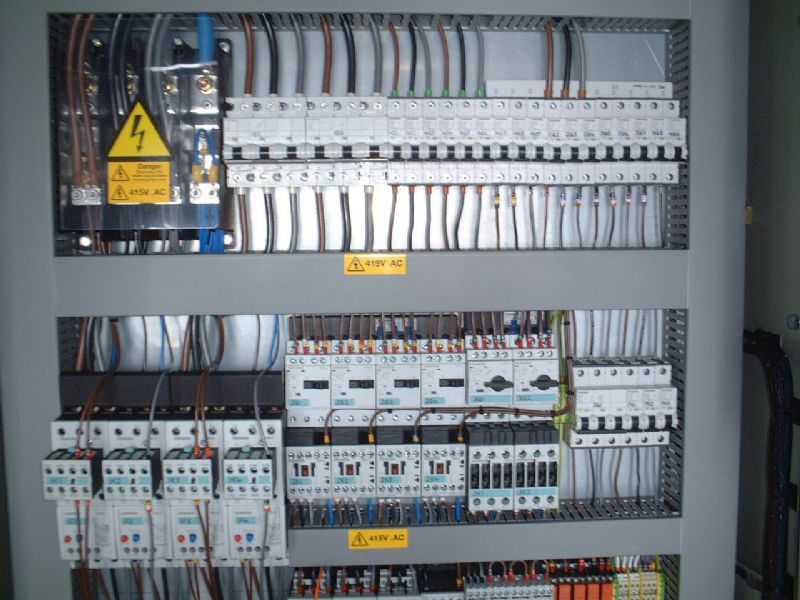

It's just a lot of really simple circuits together in one place. Reminds me of when I first opened a supermarket refrigeration panel in the plant room, "holeee shit" I pondered(n)... But it's the same, just lots of little circuits together. :cool:
