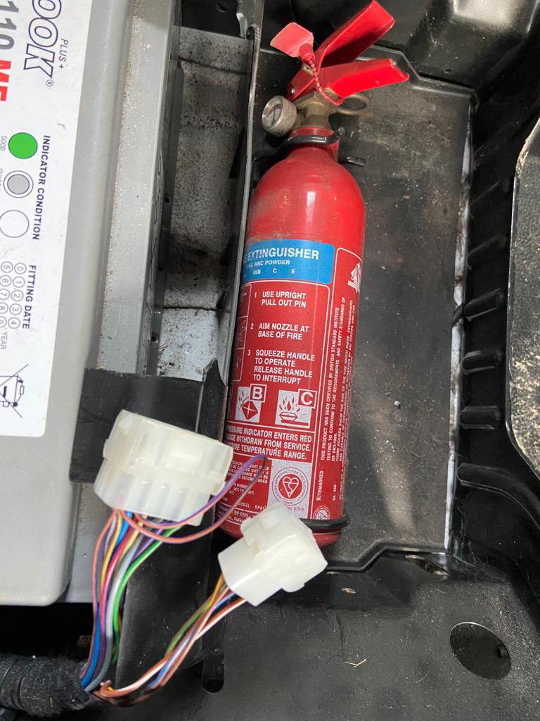

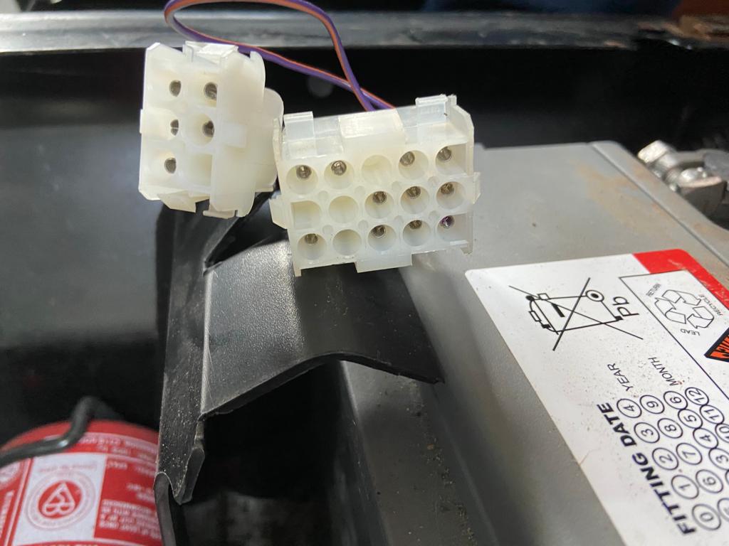

Hi Lenny
Sorry haven't replied before now, had to find the time to get in the camper and remove the seat.
The battery is 110amp.
Kettle - only if no gas
Dyson Hairdryer - only occasionally
Nutribullet (smoothie maker) - every day
Laptop Charger - Occasionally
Dyson Hair Tongs Charger - Only occasionally
TV - every day
DVD Player - occasionally
I've attached some photos my husband has taken, if you need any more info, please let me know.

One 110ah lead acid battery, it isn"'t going to run an inverter for most of the things you mention, and secondly the connections are not for an inverter ;) sorry.
And just to add whilst I commend you for having a fire extinguisher fitted I would question whether it is in an accessible place if you needed it, especially a battery related fire.
The fire extinguisher was just what we found in there when we took the seat off, we haven’t had the camper that long. Ok thanks about the inverter, be interesting to know what it is for !
My guess is that it is Ford wiring for something that was never fitted.
The multitude of wiring, size of wires and cable connector style I would say it was likely Audio equipment such as a CD Changer or suchlike.
Vehicle from 2007 would still have that in the options list.
