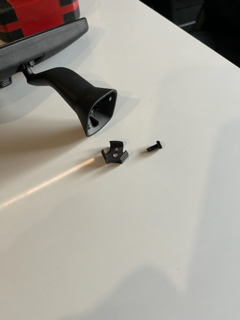

Having read through numerous threads and articles regarding the difficulties of installing a fixed dashcam mount in conjunction with the Remis windscreen blind set, and looking to fit one myself, I thought I’d have a go at it today.
This is for a 2022 Ducato with the grooved metal nut that remains on the windscreen once the mirror is removed - I’ve read a few horror stories about cracked windscreens while trying to remove the nut, so wasn’t going there. However, due to the positioning of the cutout in the Remis blind set, and the proximity of the blinds to the windscreen, that was the only possible location for a permanent camera mount.
The Nextbase 622GW dashcam (possibly other models) comes with a powered mount to which the camera simply clips into with a magnetic catch, so its just the mount that needs to fit through the cutout and here’s how I did it:
Firstly I removed from the mirror arm the spring steel clip which mates to the grooved nut in the windshield.
The Nextbase powered mount is in two parts which slide apart - the base plate with 3M adhesive on it, and the USB powered section that the camera clips onto. I drilled a hole centrally through the base and mounted the Fiat steel clip to it with an M4 bolt and nut - I pared away a small amount of the plastic web on the reverse so that the nut could sit flat - and then used the dremel to ensure the bolt thread didn’t extend further than the surface of the plate.
Then reassembled the base, now sporting the Fiat mirror clip, and the USB powered section of the mount.
All good so far and it even fitted the right way up!
And even better, the blinds do as well!
And when on the move or otherwise with the blinds stowed away, the camera simply clips into the magnetic mount and it’s good to go.
I used the optional Nextbase permanent wiring kit and ran the cable under the headlining and fished it down the A pillar to the drivers side fusebox for a permanent live piggyback feed from one of the 20amp fuses.
My Nextbase is located at the bottom centre of the screen in front of the lower blind rail. The blinds shut without touching the camera and the camera can be left in place and still record if the van is subject to a bump when parked up. Cables are fed between dash and screen. Took about 30 mins to fit.

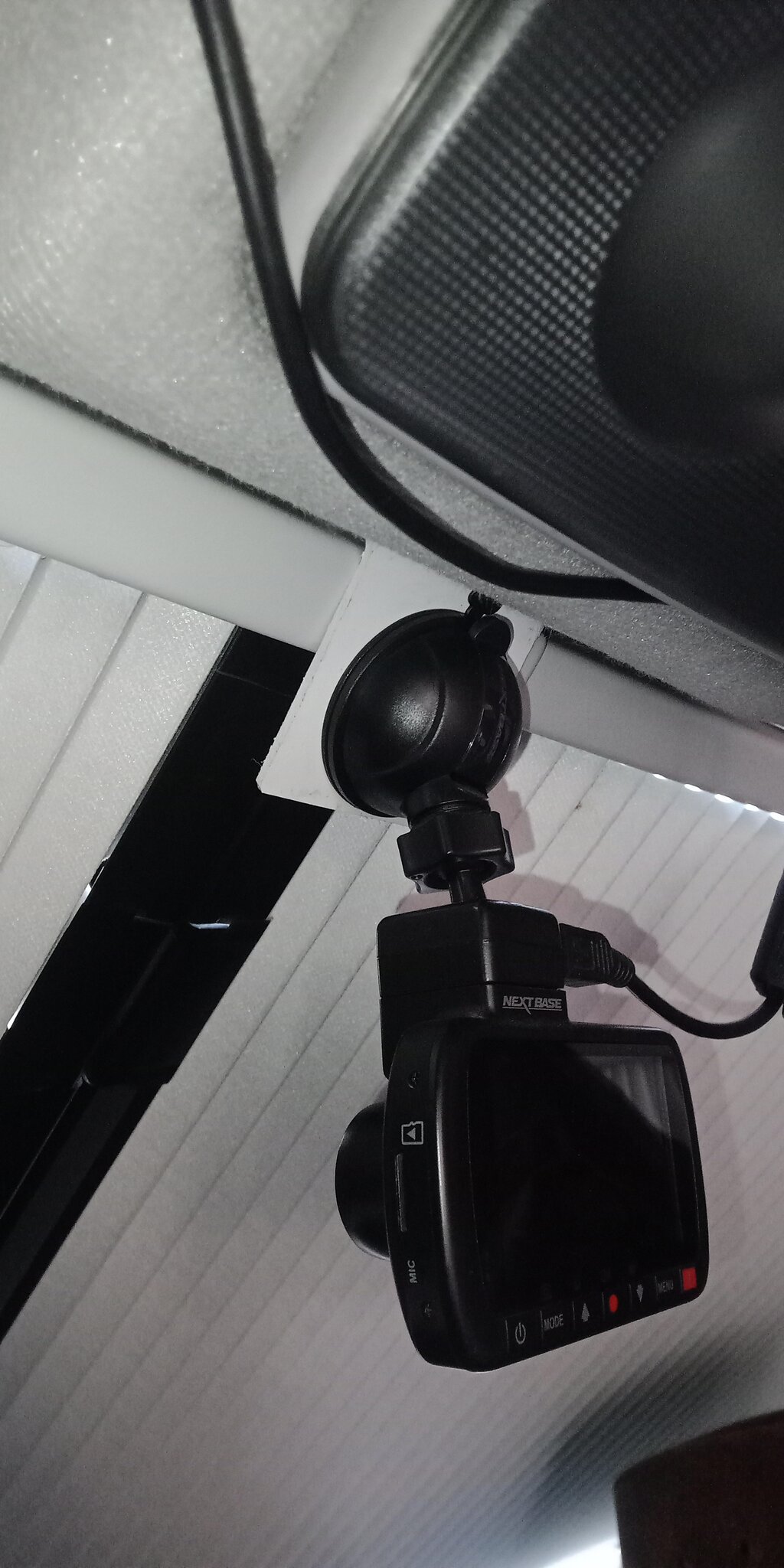

Fitted an L shape bit of plastic and used the scree that fixes the top rail on the blind, easy and has worked well for 4 years

I tried that method of mounting my dashcam but found that the camera vibrated so much that for the most part, the playback was so blurry it render the footage useless.
Not looked at the play back for about a year,but it was fine last time I looked.i will need to look again is😁.

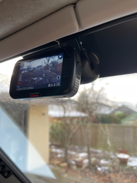

Orion,
I'm considering doing this. When I offer up the 622GW to the hex nut, it looks as though the lens wouldn't have a clear sight through the sticky black dot windscreen film. Did you have a clear horizontal forward view?
Dave
Orion,
Dave
Hi Dave, yes it’s positioned to clear that area above and the top of the dashboard below. Totally clear view forward.
