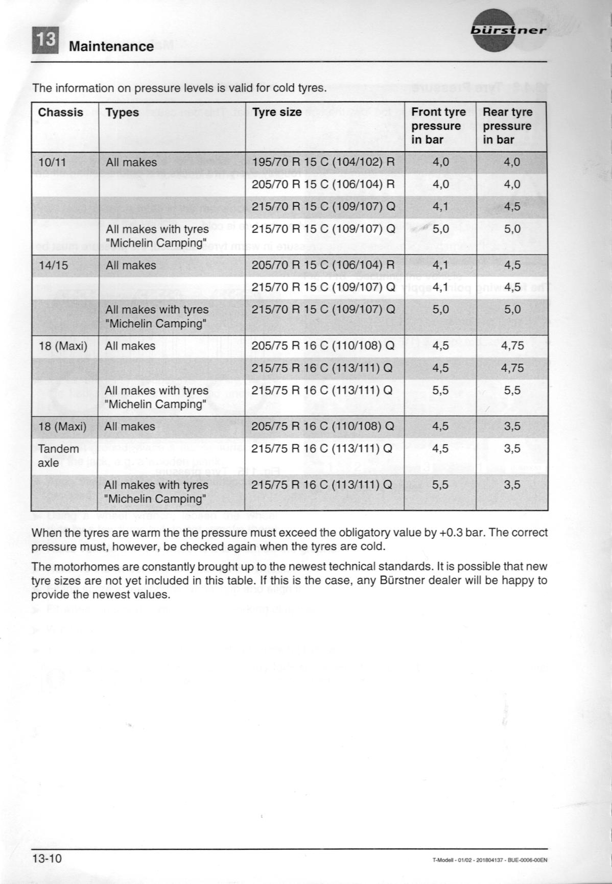

The attached image is the tyre pressure page from the manual for our 2003 Burstner t625 Harmony.
Tyres are 215/70 R15, Michelin Agilis Camping.
I inflate to the recommended 5 bar pressure, the ride is comfortable and no problems so far.
