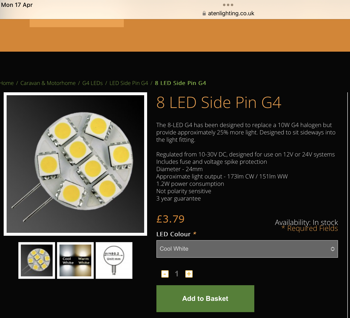

That light looks very similar to mine and I fitted side pin LED in there
I don’t think you need to buy the £9 one, it looks like the original bulb would like this
And the ones I sent link to should fit
The originals are surface mount LED's, I think it was the ones you linked too I replaced mine with.
You do need to be able to solder, you have to remove the pins and solder wire on.
