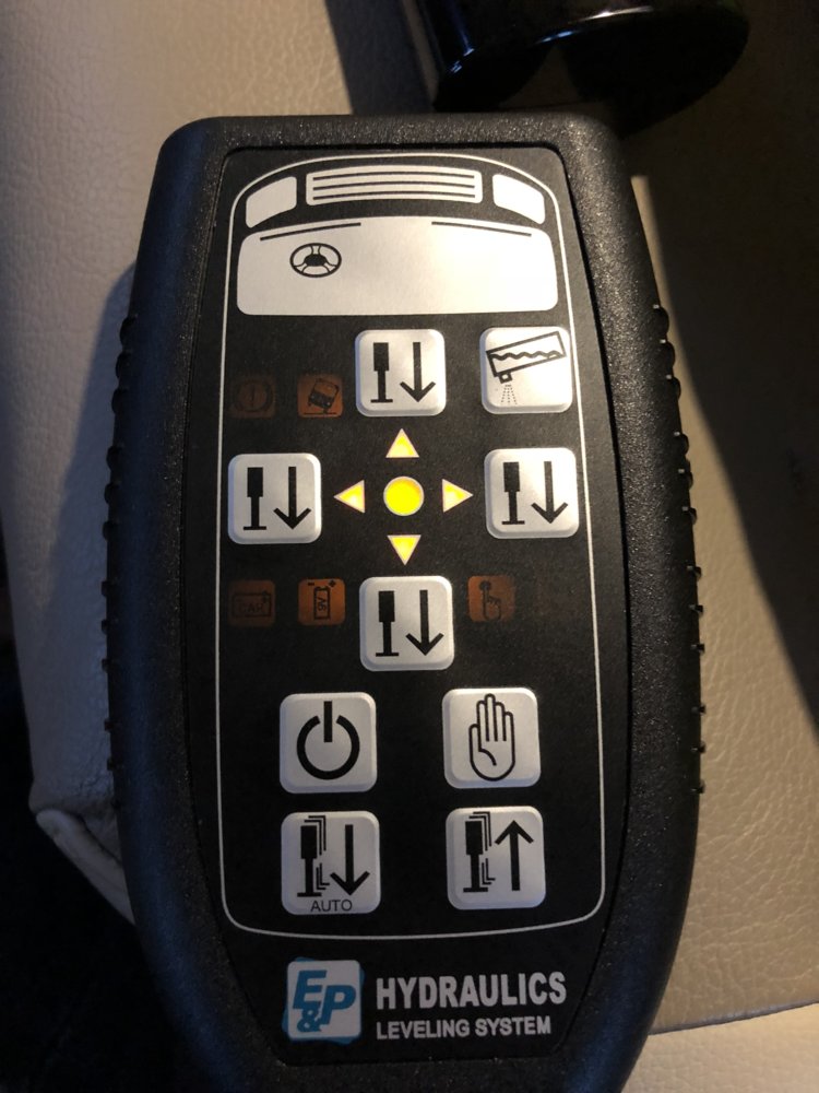

Anyone experienced a faulty remote? New battery fitted but it’s all tits up
Jun 6, 2012
1,139
1,542
Leeds
21,344
Since 2012
Not yet.....has it been a while since deployed? Have you tried pulling the fuse on your pump to completely power down the system....just a thought (y)

As @dpsuk999 says try completely powering down the system, by removing its fuse. If that does not work, I wonder if it needs to go through the connecting process as described in the manual, like it was new? Did you have a red light indicating low battery before you replaced the battery?

Can’t lay my hands on the manual just now.
First thing the remote would not respond to power button so fitted a new battery and still won’t turn on but holding down a combination of two buttons makes it light up.
The manual control still works fine

I assume by manual control you mean the fitted panel? Anyway at least the system is working. I have attached the remote manual, although no real troubleshooting. If going through the connection procedure does not sort it a call or email to Mick at SAP might be the only solution.

Hi Andy
Manuals are online https://www.ep-hydraulics.nl/uploads/documents/10c17c4fe6dfa5557e41668c1b72de37.pdf. This one is caravan but same idea I guess, could it need pairing if it’s been off for a while.

I had an experience where the remote played up and the main control kept taking over,replaced battery and rebooted by disconnecting power at battery all worked fine after that.(y);)(y)
My remote went pair shaped a few months back, SAP sent me a new one and i sent the faulty one back. They new about the fault apparently as E&P were already sending them remotes to replace. Not sure if yours is the same but mine didnt work no mater what i did to it, the manual method worked though.

I have re paired and got it working
However when it is switched off the centre green light flashes 4 times quickly about every 18 seconds and I believe this is flattening the battery prematurely
Sounds very similar as mine wouldn’t turn off which flattened the battery. I would get it replaced.

Like @zac my remote was playing up, and running down batteries.as already said, Mick at SAP was already aware af the issue, and a new remote was sent out immediately.

Mick has replied to my whatsapp and agrees I have a duffer
He is in Italy and will sort it ASAP (y)
Top service as usual
You cant beat that, when i picked my MH up from Adam's Morey a month or two ago i could hear a bleaping when turning the ignition on, this turned out to be the E&P jacks as someone at Adams morey had decided to have a play with them but not return them properly. Spoke to mick who was abroad at the time and within a few mins all was sorted. Of course now i know what to do i wont bother him till have tried it but to be honest i didnt expect it to be the Jacks as i never touched them. Top bloke though as he sorted it even though he was away.
