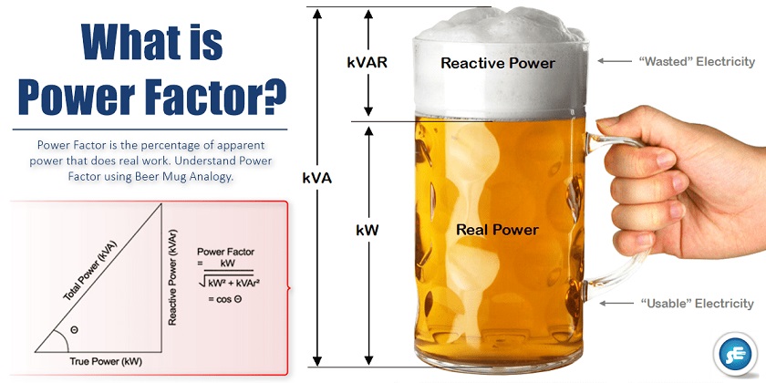

Victron is probably the market leader, and provide all that info for electrical engineering types. AC supplies are tricky take a look at the power triangle if you haven’t already, real power, apparent power and reactive power.

So a 1600 VA invertor might only have a true power of 1400 W depending on what power factor is. if you can find an appliance with a power factor of 1 you would have 1600 W but appliances are generally in the range 0.8 - 0.95
