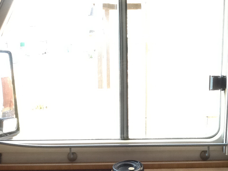

While I have my Strikeback Growler alarm fitted, I thought that I would look for a more secure locking solution for my Hymer B644 sliding window that is better than the standard plastic catch. SWMBO needed a new rotary clothes line so I was dispatched to the supermarket & bought it. Now the old one has aluminum arms and I found that by removing the plastic end cap I could cut off the excess refit the end cap so it sits nicely in the sliding window frame, preventing the window opening even when the plastic catch is unlocked.

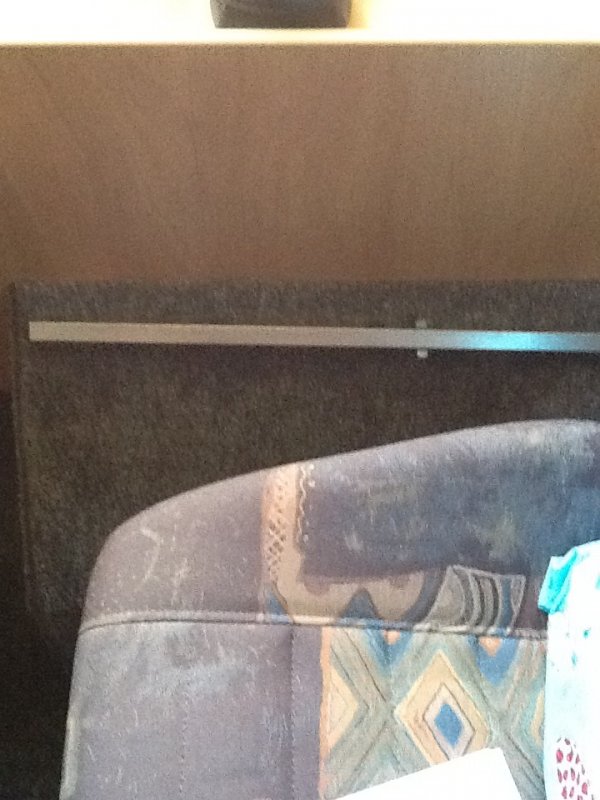

I screwed a spring clip to the bulkhead of the gas locker (avoiding any plumbing on the gas side) so when not required it lives there nice and tidy.

See the photos attach.

Had something similar for a few years now nice thin strip of Ali just drops in the runner stops the wondow opening. Have a piece of wool tied around it to lift out works well.
thanks for info i have a threaded rod in my pilote
Yep - I simply lodge a rod cut to length in the channel. Silver screens recommended doing this when I got the covers
