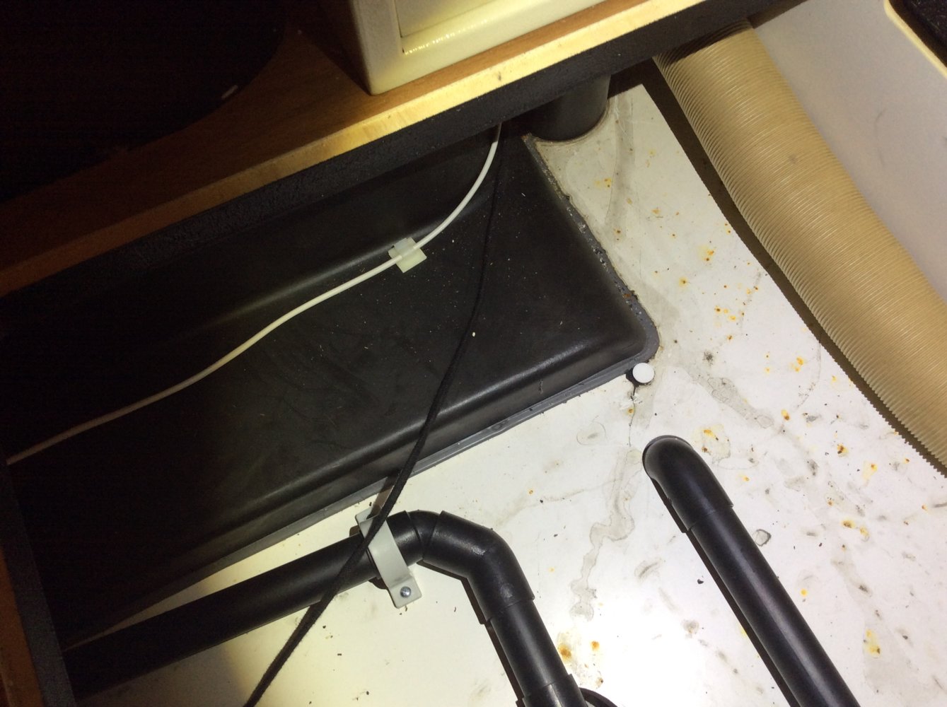

Heads up for owners, been on a site in Spain for almost 4 weeks, yesterday decided to clean out the garage and was horrified to find mould and spongy panels at front of garage in small alcove on the offside as photos. Lifted the Hymer waterproof mat in garage and found it wet underneath on offside stretching across to the mid point. Moho is a 2017 registered model and the bottom of this alcove is about 5 inches above the garage floor. I posted a heads up on the fb Hymer Owners Group yesterday and another member checked his this morning and found an identical problem. Carried out investigation this morning but nothing defiante found to narrow it down, condensation, ingress from outside there do not appear to be any internal leaks in double floor. Obviously this is very worrying on a van not 2 years old.

Further investigations today, emptied the underbed wardrobe immediately in front of the garage bulkhead. Nothing obvious the black object at top of photo is the plastic wheel arch, in right hand top of first photo behind the heat ducting pipe is the backside of the alcove, no obvious signs of damp, mould or distortion. There are what appears to be dried water runs across top of lower floor and rust spotting. The black pipes are kitchen sink and bathroom drains, water was run through both and no leaks. The other owner with identical damp areas in alcove found exactly the same down to the dried stains and rust spots. My guess is water ingress is on garage side but where from is the worry, as in previous post this alcove though adjacent to garage door is 5 inches above garage floor. Surely it cannot be a condensation issue?

Philip seems strange that bottom of alcove which is the top of the underfloor is 5 inches above the garage floor, the identical alcove on nearside is perfect. And to have another owner have an identical issue could it be a design problem? Thankfully it’s still within its warranty period.

You mention that there are what appears to be dried water runs across top of lower floor and rust spotting. Something must have happened to have caused that, especially as the other owner with identical damp areas in alcove found exactly the same down to the dried stains and rust spots.
Have you checked the wheel arch thoroughly? As the pipes don't leak, I would suspect water ingress through the arch. Did you drive through wet weather conditions to get to Spain? Looking at your photos it does appear that there is water staining coming from the corner of the black plastic housing on the arch.
Water finds the lowest level so, as its on a level higher than the main floor, I'd rule out leaking from the garage door.

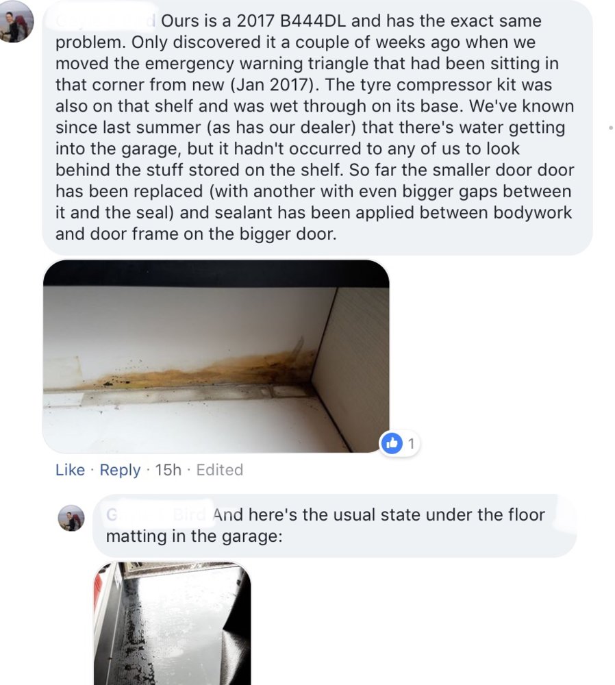

Another group member has reported the identical issue but this time with a B444DL model, photo attached. It has been raining during the night and steadily raining now, forecast is rain all day once it clears I will inspect the garage floor for wetness.

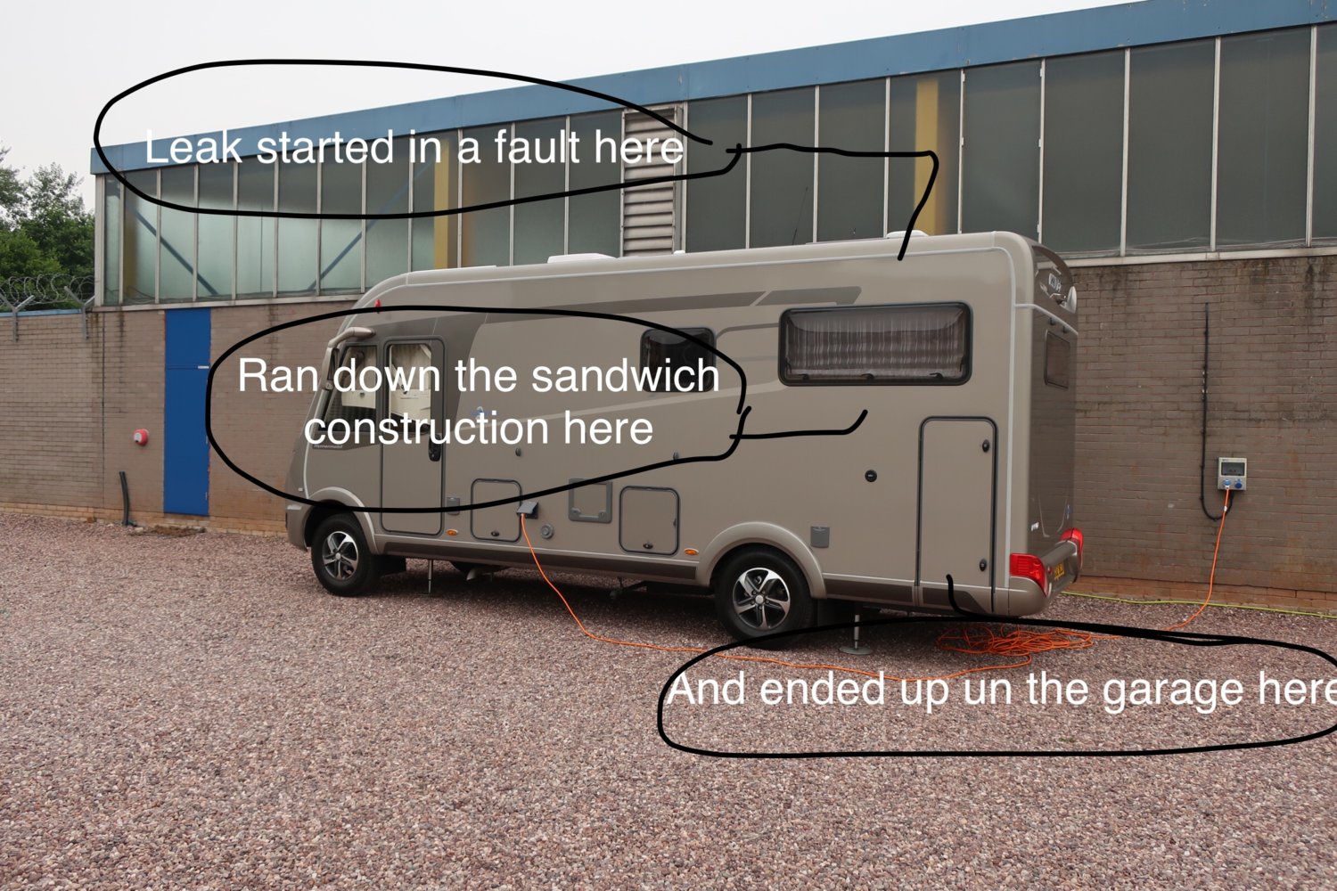

The problem we found with water ingress is that where the water is found, and the point of entry, can be entirely different, especiwith Hymers PUaL construction.
We found quite a lot of water in the garage of our 2017, and it transpired that the leak was actually at pretty much roof level, the water was running down inside the PUaL panel (which has hollow channels in it), and running out into the garage. There was no evidence of any damp in the van at all.. but no doubt if it had gone unnoticed in the garage then some mould type evidence would have shown itself
The picture below shows better what I mean..
The good news is that the problem was completely remedied in one trip to the dealer, Travelworld, who were superb throughout the whole episode (and in fact it was them that identified the source of the leak - I’d never have thought to look where they did and had assumed faulty door seals).

So the gutter was leaking originally then which caused all the problem, I must say I also wouldn't have looked there either. They must have found it by seeing that sealant was missing in that area?

Nice one Millie that could explain the water in the garage, but the damp panels in the alcove which is about 5 inches above the garage floor? Surely there cannot be two issues here! Worryingly the base of the alcove is the underfloor of the van, if this is affected then it would be a major issue.
