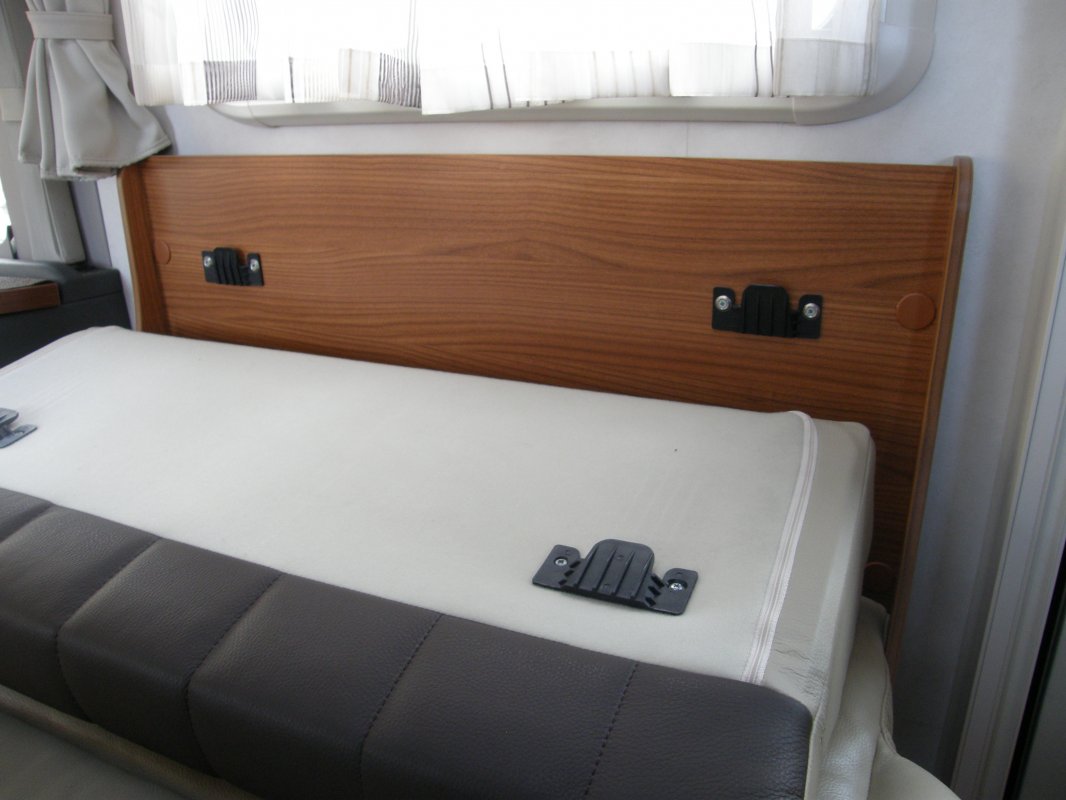

5 years
Our Hymer also 2012 (B654SL) doesn't have this problem but, where required, the seat backs hook into a plastic retainer. It may be worth having a word with the parts guys at Brownhills, we have never bought a van from them but, these guys know a lot about Hymers and have good contacts at Hymer.
Any chance of a quick pic?

That might still be happy to talk to you but I thought Brownhills had lost the Hymer dealership?
They are no longer Hymer Dealers but, still hold large stocks of Hymer spares and are still very much in contact with Hymer, although I bought through one of the new dealers and have the hab servicing done by another, if I want to know anything or need spares, experience has taught me to phone Brownhills! In fact the spares guys still wear Hymer logo's.

I will see what I can do.
Although on the other side we have the same as you but no problem with it whatsoever.

On our current van the side sofa back is held on the same way only had the van 7 months, just had a look no signs at all of the fabric tearing , probably only taken it off a few times when doing wiring mods.
Last van same fixing had it for nearly 6 years again no problems, sofa back would have only been taken off 2 or 3 times a year though.

Thank you for the photos that brilliant. I bought a roll of 100mm wide fluffy Velcro off fleabay and am having it sewn across the back and bottom cushions. Should pick up on Friday when done and will post up results after....
