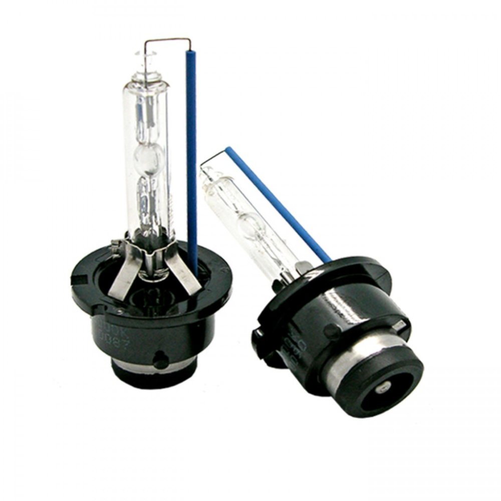

It would seem that I have HID lights on the main beam (High Intensity Discharge). That would explain why they are so bright on main beam. They use a ballast resistor (which I believe I can see in the wiring just below the lamps) to fire them up to a higher voltage apparently which could explain why I didn't get a reading on my multimeter? (had that set to 20 volts). Main fuses all appear to be OK but there could be additional due to this appearing to be a mod. With the connector that goes directly onto the bulb coming off it could have shorted out and also damaged the ballast resistor I suppose. I can see the lamps available on Halfords, but quite where I'd look for them here in Spain goodness knows. Not intending any night driving so not too much of a worry unless I got a roadside check on way back up through France.
This looks exactly the same connector that I have. It could be the lamp that has failed that I assume I should still be able to check with a multimeter? @scotjimland Jim, any thoughts?

Lots on tube which I've been looking at. Best diagnosis seems to be swapping lamps left to right to begin with, followed by switching the ballast resistor.
Yes, also read about some of the issues surrounding these mods. It appears to be a 'proper' job all well installed and for some time I would guess. The lenses have also been replaced and are of the projection type.
Probably will be limping home with only the one working...but it won't hurt to have a play around...with the lights turned off!

Went through a process of elimination this morning starting by swapping the left and right bulbs over. That showed that the bulb was fine. Tested the incoming supply to the ballast resistor and that was also fine. All four front lights are HID. Removed the suspect ballast resister which is a Hella Unit but nothing obviously untoward. Cleaned all the contacts up as best I could, refitted and hey presto it burst into life.
Much thanks for the help and putting me in the right direction...very illuminating :rolleyes:.
They have Clearly been fitted for sometime...maybe even original spec as all looks well fitted and the four projector lamps appear to be the correct type and not just an amateur diy job. It could have been imported like that. There is a mod on the dip lamps that allows adjustment from UK to European travel.
Not sure what the MOT will turn up in July. The light burn white with no hint of blue and I have never been flashed on dip beam. I may well go and have the lights beams checked out though before I present it for MOT.
On main beam they are exceptional...for an older Hymer. On Dip they are pretty much like any other vehicle I have driven.
