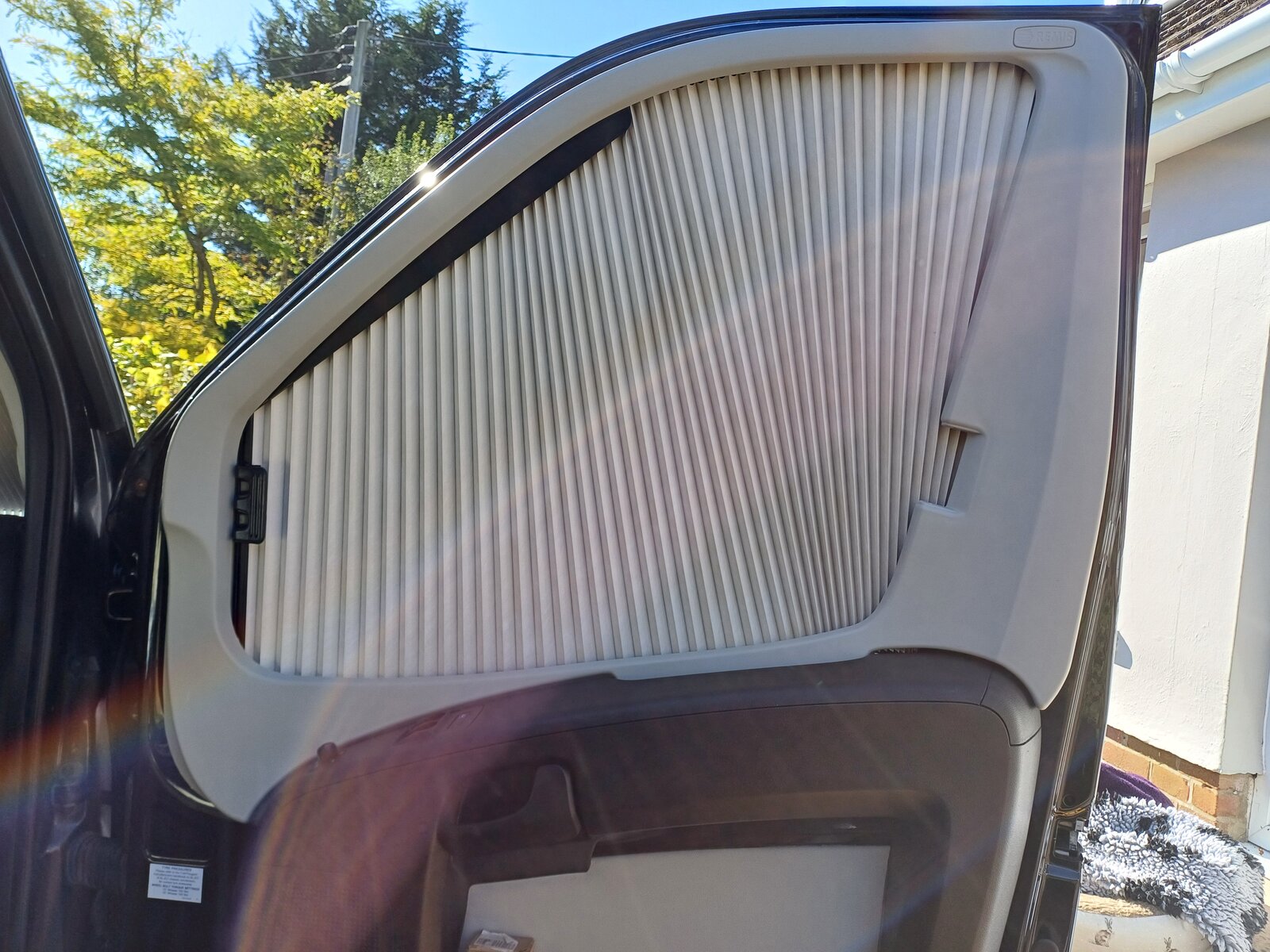

Further to Sabso's post #8, I replaced my blind to day. The instructions mention drilling a hole for the black "mount" but fortunately the damaged blind frame had one already. Photos of damaged torn blind and new.
