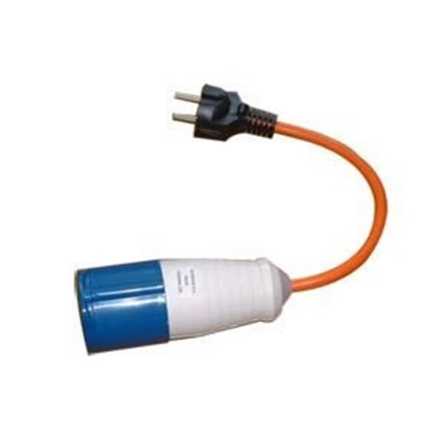

You may Need one these in abroad 230v to euro connector
