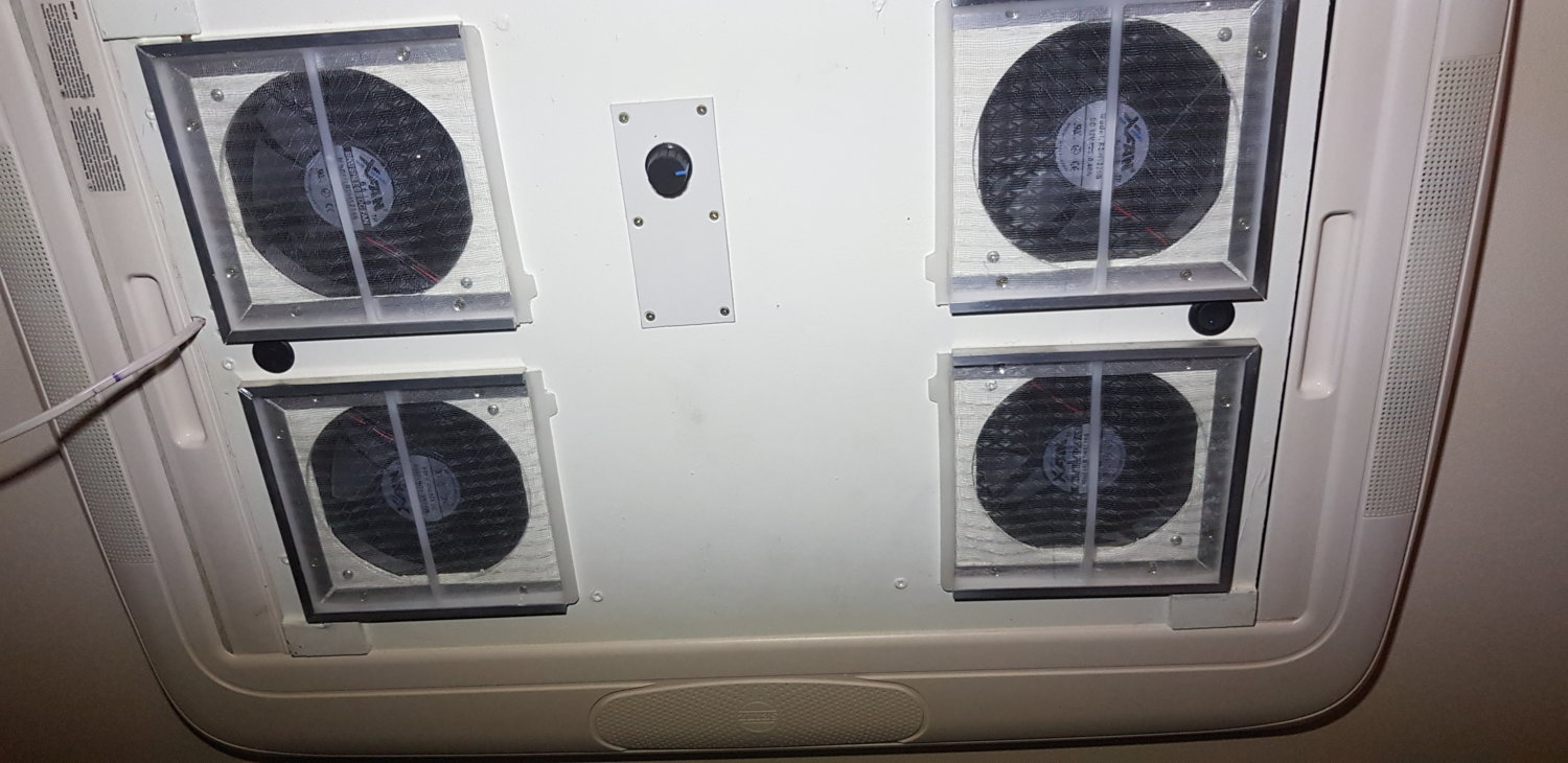

Home made extractor fan MK1.
Apr 6, 2019

Car 12v radiator fan. £17.50
Spare extending spring rods £4
Old cable lying around in shed. £1
Speed controller £4
Connection to Load terminals on Solar Controller - free energy?
Speed adjustable fan that will fit anywhere the rods will - currently my biggest sky light very near the cooker.
Very pleased. Tidy cables another day.
Approximate cost?
Shed 6mm plywood £free
The fans were about £7.50 each on ebay Xfan brand, unavailable now.
Switches about 50p.
Speed controller home made with 555 chip and TIP 32 transistor... Maybe £1
Mozzie guards are cut out of an old wall mount AC filter and slotted into some scrap pieces of aluminium channel £free ?
Room thermostat about £10

I like the idea of the big car radiator fan. The bigger the fan the lower the RPM to shift the same CFM... Lower RPM = lower noise everything else being equal...

My thoughts exactly. Pretty quiet at low speed and having tried it on low speed with vent on first latch (opens one side around an inch) you can feel the air being pushed up and out. Now thinking about a grill to cover inner side (although at 6'2" I am nowhere near touching it with my head :) ), but am aware that may introduce an audible droning noise.

I was going to use acrylic and mount large computer fans on it. Probably going to mount it on the smaller skylight abouve the kitchen area.

All good. Will add some of those little u shaped holders for the legs to ensure it can't drop unexpectedly.
Being a large fan it is near silent on lower speeds.Screenshot_20200209-165621.png
