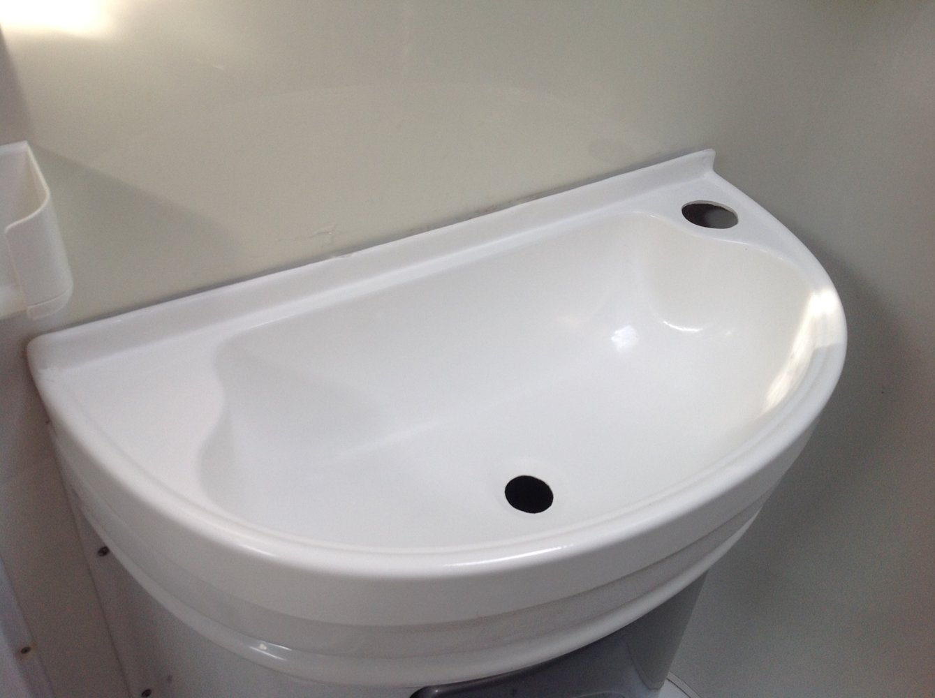

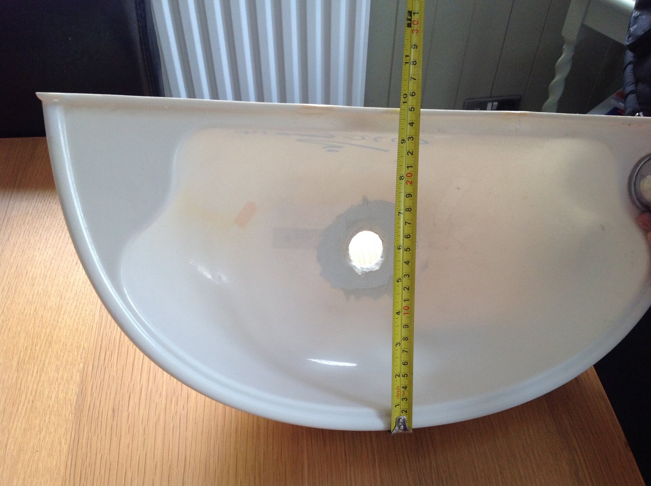

We had a replacement sink made by Derek Justice GRP Leisure at Derby he can make a mould for any sink, shower tray etc we were really pleased with the result it was far better than the original.
I dont need one but it sounds ideal for future reference just in case, but what cost are we looking at for your job?
I think we paid around £65 which we thought was very reasonable this is a before and after ours had cracked round the plug hole
