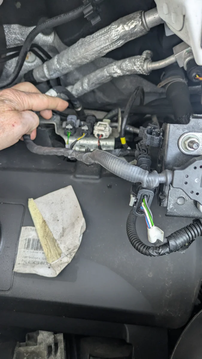

I have this fault P0130-01 and the engine warning light as expected. I need to get an MOT urgently as we are supposed to be Europe bound on the 19th! If I monitor the O2 sensor with Multiecuscan it shows no output voltage or percentages. A mobile mechanic said it's the sensor at the very top of the exhaust just at the back of the engine, which is connected to a module directly in front of you when you open the bonnet buy the earth stud. I am not convinced as I notice there is another sensor (5 wire) just to the right of it, also on the top of the engine.
I know there are other sensors as well, so which is correct please any help appreciated.
The unit by the stud is input nox sensor...there is another at the back of the exhaust mounted on top of a heat shield output nox sensor.If you Google O2 sensor and then nox sensor you will see the difference
The module you highlighted is connected to a sensor right at the top of the engine, the layout is different. I will try for a photo to save confusion. Back soon
The module you highlighted is connected to a sensor at the top of the engine, the layout is different. I will try for a photo to save confusion. 1st picture shows both sensors accessible direct from on top of the engine. 2nd show the module the left hand sensor is connected to which is just below the earth stud. HTH
My post above is the layout on my 2020 boxer but the goggle bit brings back nox and o2 Sensors for your van looking the same as mine
The part number of the sensor connected to the module is a Nox sensor, my question is, is the other sensor in the photo an oxygen or perhaps a temperature sensor. So many versions its hard to tell, I did find a sensor that is looks like it has a waist like the RH one and it was oxygen lambda.

The right hand sensor is the 02 sensor, with the left being the NOX sensor. The sensor was replaced and everything is back to normal now. For genuine parts you can use Coastalmotorhomes, they do an overnight service. I can supply the NOX and O2 part numbers for 2021 140bhp 9 speed Maxi XL if needed.
I would appreciate the part numbers, is the 2021 known to have different parts to earlier or later?

The Nox sensor is connected to the module right at the front of the engine, search coastalmotorhome
46341847​
The O2 sensor (Upstream) is just to the right of the Nox sensor as per photo
55281073​
