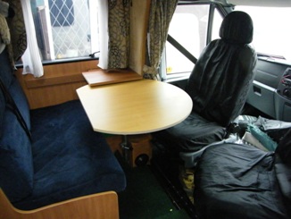

We had a similar layout, took the table off the wall cleaned everything, sprayed with a silicone lubricant worked much better.
But it was too big we looked around for a smaller table top, but the prices were ridiculous from most suppliers, in the end we decided to buy some cheap worktop (ikea) cut to size and replaced. - It works very well, meant to be temporary but not changed after 3 months, theory was to try size then get something proper. The new table is shorter and narrower, it is easier to move and gives more room around the table.

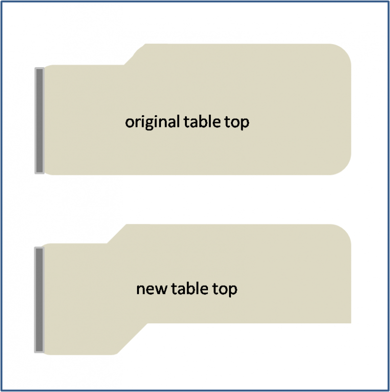

Your table is already quite tight for space so the problem of being able to push it sufficiently forward to the cab seat to be able to get into the dinette seat wouldn't be solved simply by replacing it with another lighter version and I'd be reluctant to reduce the part which links to the rail on the side of the van as reducing this width could make it unstable, instead you could make a dogleg style table so that the link part is the same width but the rest the table has a width reduction - in the photo attached you'd make a table top and cut out the coloured in section. I'm sure it wouldn't be difficult to still be able to adapt if for bed making duty too.
Not quite sure I'm following you here. I was thinking cutting away a duplicate on the RH, what benefit is it on the LH, I'm probably missing something here.
Table looks great but have you tried it making up the bed?

When we had a Chausson Flash 04 I removed the large table which was similar to yours and replaced it with a different top on a cranked table let, as well as a small flap table/shelf at the side, I off-set the cranked leg so that we had more adjustment on the table top to get it just right and the flap was set just above the height of the table so that the table could swivel round underneath it to save having to put the flap down to use the table, it worked a treat:
I assumed that your main problem was getting in/out of the dinette seat, rather than the cab seat, if it is the dinette it would obviously allow more space between the seat and the table, if however it is the cab then of course you would want to reduce the table on that side - which are you having a problem with exactly?

Having trouble with the whole thing really. You just cant slide it either way without lifting the thing up, in which case it has to be clear. I'm really liking your photos though cant quite see whats supporting the weight.

This close up shows the leg under the table, the top lifted off completely if required hence why in my first photo above you can only see the cranked leg, most of these types of legs don't allow you to lift the top off.
This is the shape I was talking about for your revised table top.

Getting the hang of it now. Think I will be showing this to a local joiner. Will save on changing MH as otherwise we are happy with the layout etc. THANKYOU
