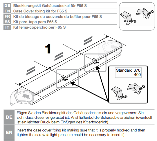

@jezport have you you had any problems with the Fiamma awning case, mine closes at both ends but it doesn’t click in in the middle, I fit a long zip tie across the middle.
I’ve reported this twice with SMC but they say there’s no problem.

Mine has a slight gap in the middle. Think they are all like that, too thinner metal. I think it's caused by the awning fabric when the wind balloons it up bending the case.
John.
Have your awnings got the 2 small bracing brackets fitted to the top to stop the casing flexing? When we got our Familyscout from SMC they fitted the new Fiamma awning but hadn't bothered to put them on but they are a necessity for longer awnings.
Yes Mel we have the 2 small brackets fitted.
John.
