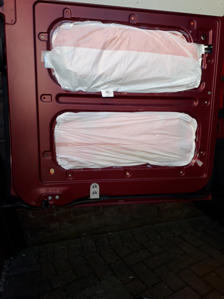

Today's task: Insulating the rear doors.
I've also included a few pics of how to remove the 2-stage retaining clips as not everyone will be familiar with them.
Materials: I used a 4m x 400mm (wide) x 180mm (depth when fully decompressed) of space insulation blanket but I had to reduce this to 120mm and compress it slightly so that it fitted the 75mm door cavity.
Observations:
1. The doors have no internal insulation properties whatsoever therefore it's no wonder that they lose so much heat energy when the temperature drops outside.
2. Once the doors are insulated and 'packed-out' then they become a lot more solid to the touch and no longer sound like pieces of hollow tin.
3. This fix will apply to any Fiat-based PVC as IMO if Globecar can't be arsed to do a proper job then it's unlikely that any other manufacturer will do better.
Here's the pics:
1. There are 12 x 2-stage retaining plugs to remove just like this one:
2. Split the two-stage head (I used two cutlery knives):
3. Twist the knives gently to pop the retainer:
4. Pull the plug and repeat the process eleven more times:
5. You now need to remove the door opener (round button). Place an old cloth against the metalwork so as not to damage the internal paint - then gently massage and pull the plastic card as close to the button as possible. The button will pop off:
6. Here's a pic of the actual door button behind the door skin - i.e. to ensure that you know what to pull and in want direction:
7. The main plastic panel will now drop off leaving you with the door cavities and some crappy bit of sound insulation material:
8. In my case I removed the black stuff to ensure that I could pack-out the appertures properly (Info: The black foam is 20mm thick while the door cavity has a depth of 75mm:
9. Here's a pic of the door cavity (looking upwards) which runs up the side of the window so as you can see there's lots of space to fill (The blue foam thing is the unlocking wire (contained within) which connects the top lock of the door to the central latch):
10. Next comes the packing phase with the silver lining of the space insulation facing outwards to the bodyshell (Note: the wires shown supply the two number plate light holders):
11. More bits of packing:
12. 30-minutes later and I've packed out everything, including the voids next to the windows and behind the locks etc etc. I then tape two white plastic covers over the appertures to seal it.
13. Then reapply rhe 12 retaining studs and push/bang the circular button back into its apperture - job done! Then go for a coffee and come back and do the next one:D:

That’s a good job done Andrew and good pictorial instructions, I might insulate my doors too I’ve also got the plastic tool kit to remove buttons and trim.
John.
