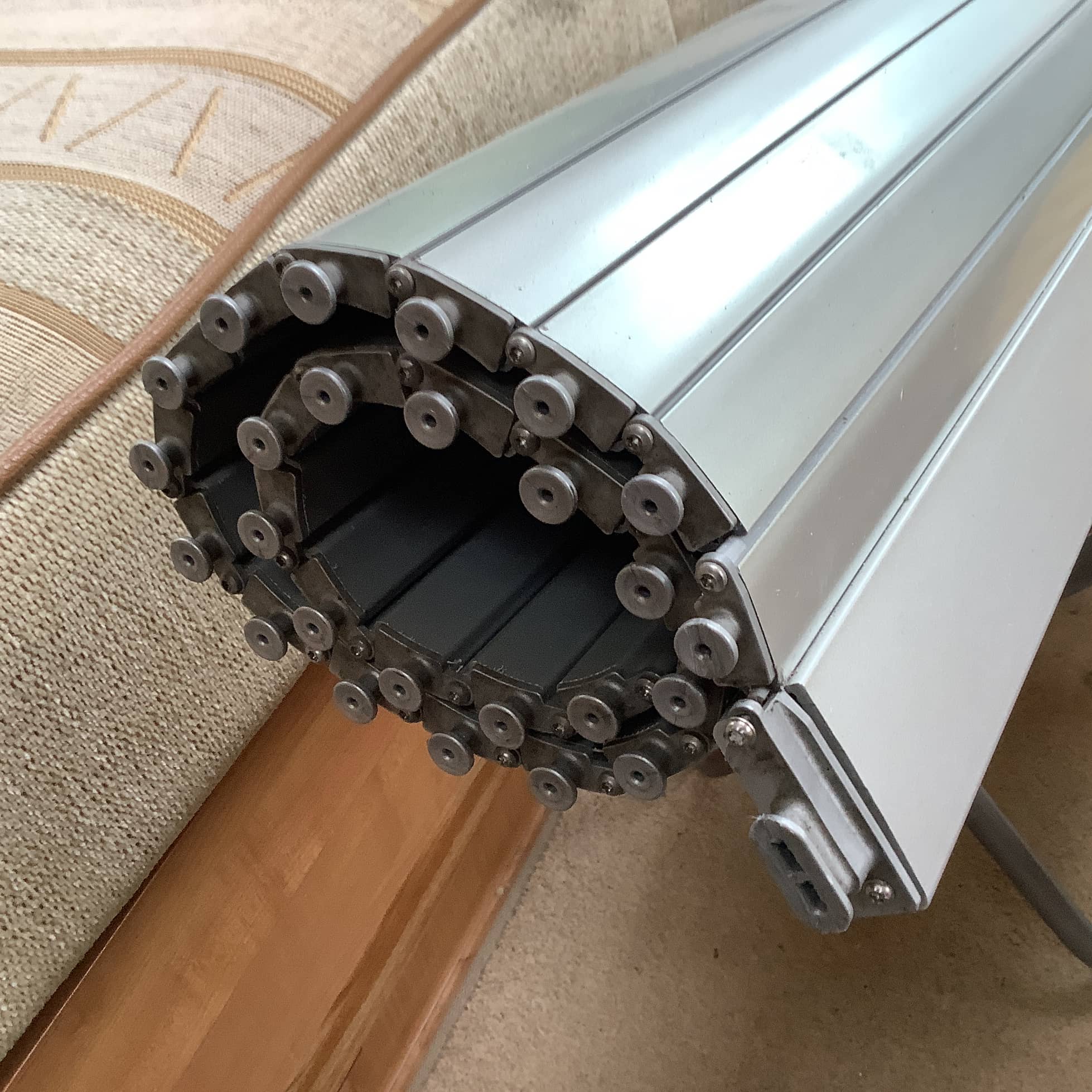

Our shower door is playing up. The top runners have always been like the photo - located in the track but floating in the plastic slats of the door, so they don't support the weight of the door. A couple came out and as I fixed it I noticed that a couple seemed to be glued into the slats (like the one on the right). Could someone check their's for me, please, and let me know if they should be glued in and thus supporting the door, or does the door weight rest on the shower tray rail and the top guides float and just act as non weight bearing guides to keep it aligned the top track?
Bump - Doesn't have to be a globebus one. If anyone has a plastic tambour door I'd have thought they were the same... Anyone?? Was yours like this Minxy ?

Having taken a tambour door out and removed a couple of slats previously (it was too wide) I seem to recall that the top inserts were fixed into the vertical slats as they didn't move in/out, the door was supported by the top runners and the bottom was just a guide which meant the bottom could jump out occasionally.

Interesting. Our's, then, is the other way round; the bottom slides (or, more accurately, drags) it's weary way through a jungle of shredded Labrador dog fur bearing the weight of the entire contraption, while the top merrily jumps out occasionally.

Burgo I've checked mine today and the bottom is free of the shower base but fits within a guided track. The top ones are all very snugly fitted into the door and that then hangs in the top runner track. You can hardly see mine but I’ve put a photo here for you to see.
Thanks everyone for the replies - it seems pretty sure that ours needs the guides inserted fully into the slats so it "hangs" on them. I'm minded to do a test on them, maybe temporarily wedging the guides in with a shim of card / toothpick / bit of inner tube rubber / whatever before wielding the araldite or pop riveter for a permanent fix.

Thanks for the info go. Ours seems to be a slightly different design, though. I've had it apart and our thoughts at present are that it seems as if the top "tee" runners are meant to be vertically free floating in the slats. I've given the top and bottom tracks a spray with PTFE lube and, touch wood, it's running better than new at the moment and hasn't derailed.
