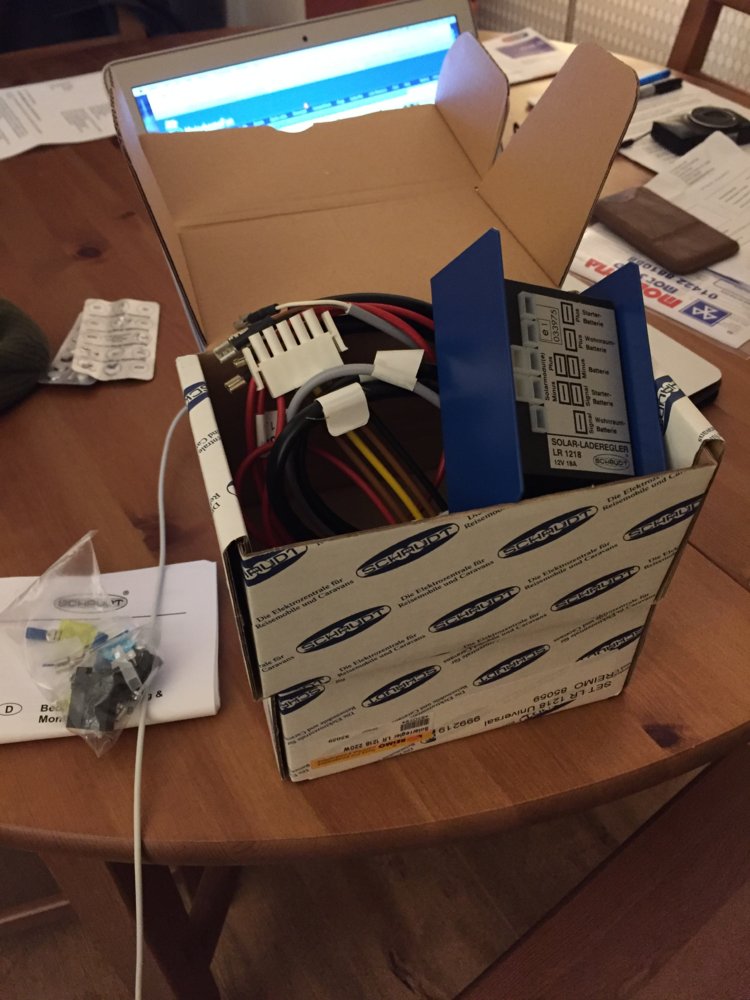

One I brought 2 years ago didn't have the split loom lead for the ELB 99, previous one about 7 years ago did.
I wonder if it was an error that you didn't get it as I bought our LR1218 last year and it came with the lead.
