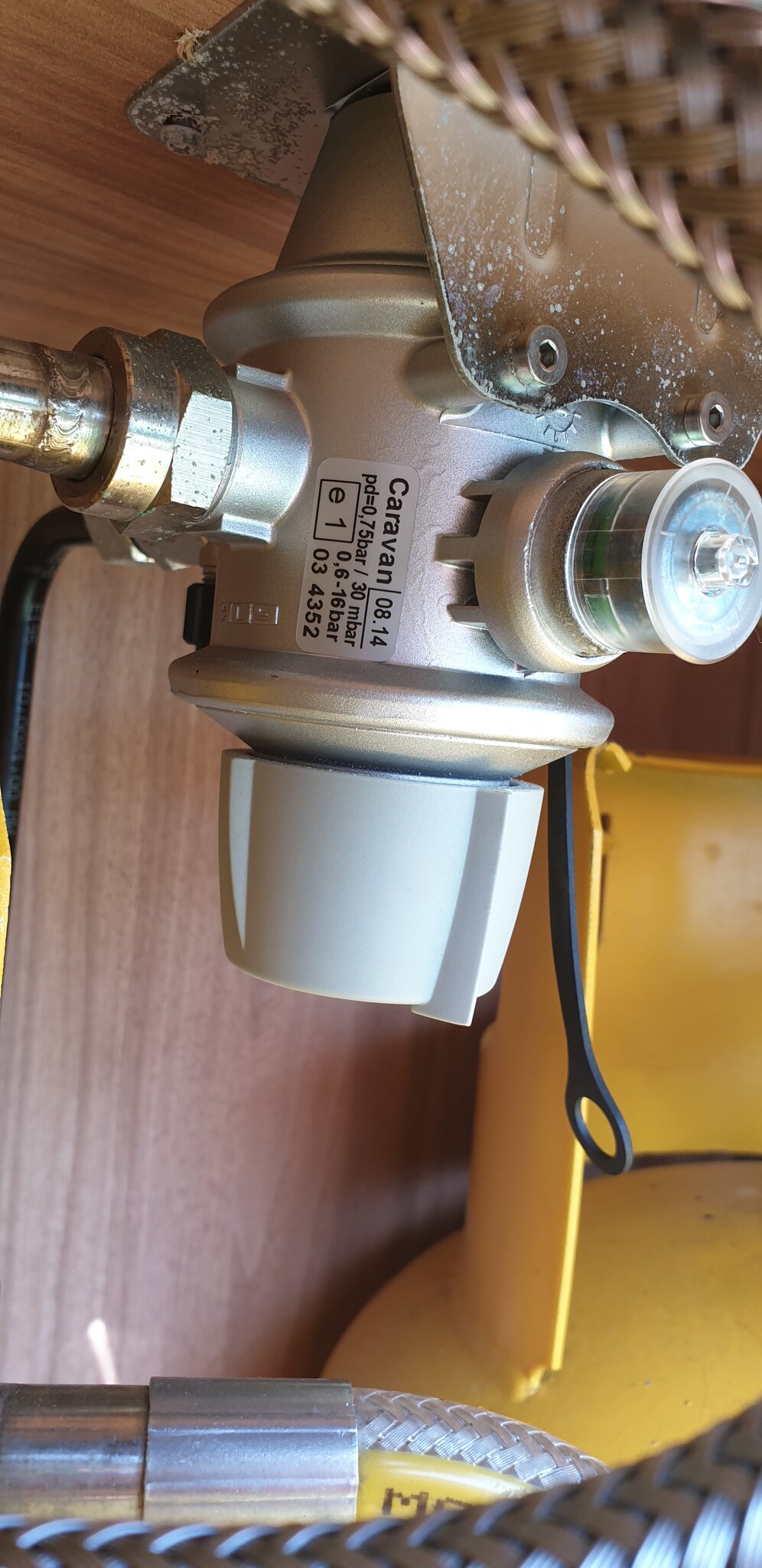

Post a picture of your hoses and regulator etc 👍

I have the paperwork for the Truma crash sensor but they must have taken it off when the Gaslow system was installed ☹️
One of the hoses show a date of 2023, so the probability is the rest are the same. :unsure:
