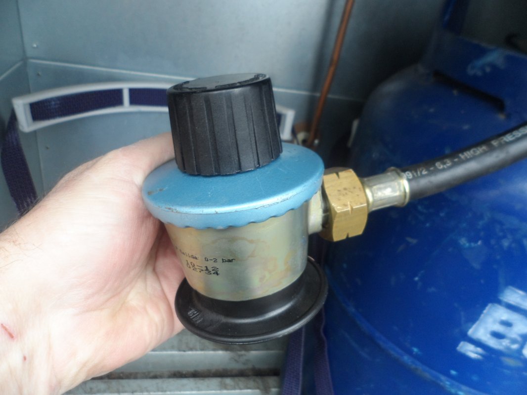

If you are running Butane at present you can unscrew the clip on UK adaptor, Buy a Spanish "Jumbo adaptor"... NOTE THIS IS NOT A REGULATOR..
Then use this and it will go through your bulkhead regulator thats already fitted to the van.. If your locker is big enough then you can stow the spanish bottle in there...
Then use this and it will go through your bulkhead regulator thats already fitted to the van.. If your locker is big enough then you can stow the spanish bottle in there...View attachment 53106

Yes...
If you are using Butane (blue) then its just a simple change of the clip on UK to the Clip on Jumbo adaptor.
If you have Propane then you will have to buy a new butane "pigtail" and this will connect to your bulkhead regulator.
You can get an adaptor in UK off ebay or several leisure outlets or wait until you get to Spain.
