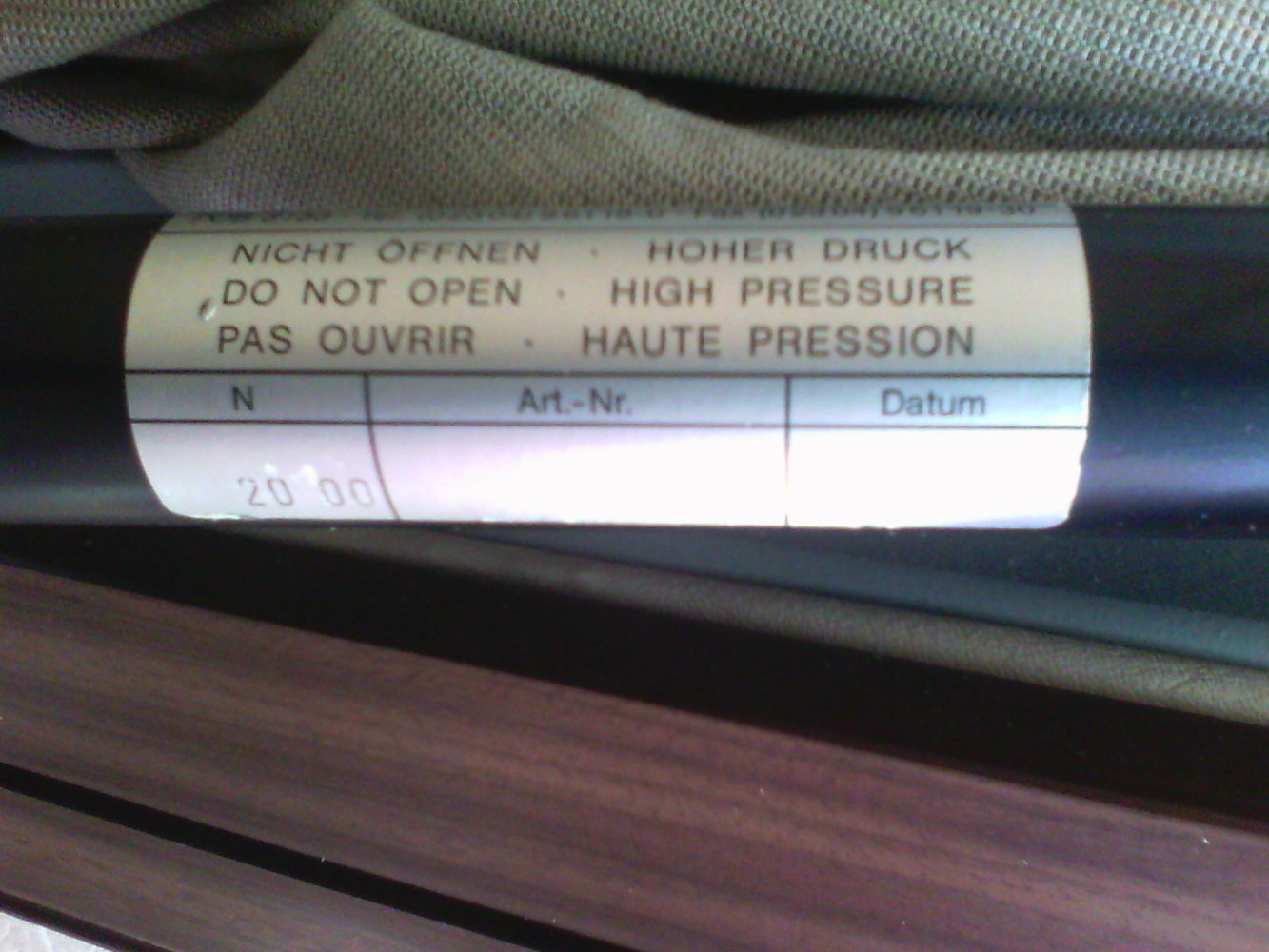

As the drop down bed in our 1991 FFB Tabbert becomes increasingly heavy to lift, it is time to change the gas struts, or, more likely, have them changed. However, perhaps due to age, (of the van that is) have been unable to find MoHo accessory supplier prepared or willing to track the parts here in Spain.
So, I guess it comes down, scarily, to a DIY project.
Can anybody explain the data off the label attached to the arms (see photo) and suggest a UK source prepared to post to Spain?
Closed (ie bed down position) the arms are 37.5cm long. Do I need bed up measurement also?

Received gas struts, in Spain, from SGS but totally the wrong sizes in spite of precise measurements being sent via their web site ordering system.....twice!!! Their complaints dept have responded very promptly and I am told the "correct" struts are being dispatched today 4 May.
Last lot took best part of two weeks to arrive so guess our planned departure is now on hold pending arrival.....Bummer!!
Top one in photo is original, the other fits........ A dinky toy maybe???

The on line order system is very user friendly providing a schematic of a gas strut showing exactly what measurements are needed and if I could follow it ........ Anybody can!! Having said that, the above photo shows the result of my measuring skills!!!!

looks like inches vs centimetres to me...
