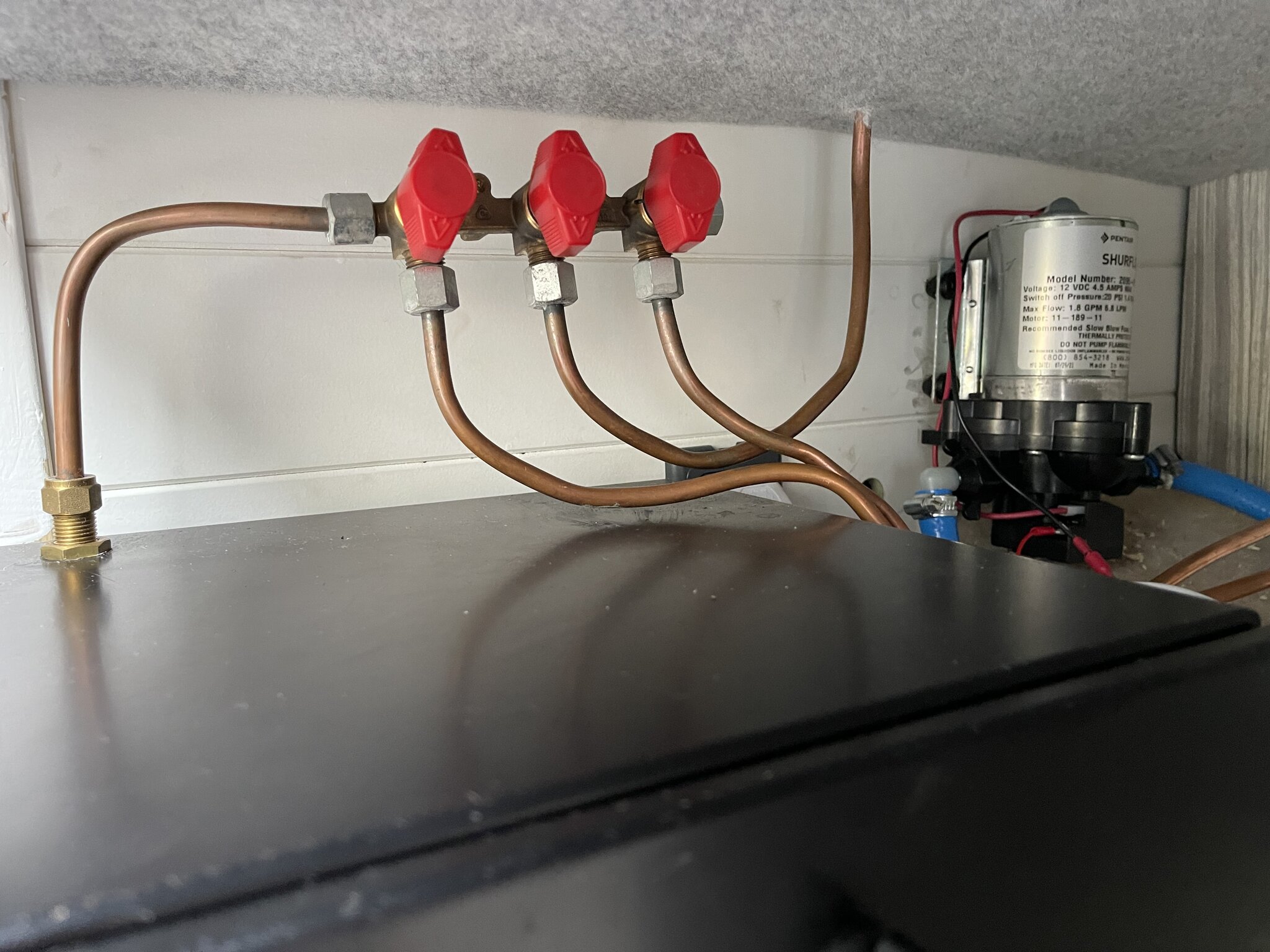

This is a gas installation carried out by one of the alleged professional van conversion companies.
The current situation with a trade organisation in partnership with the supposed 2 main leisure industry clubs is a complete joke at best and a recipe for disaster at worst .
The gas manifold is not fixed to anything so hanging on the gas pipes ⚠️

Well there are bodges and then there are potentially lethal bodges!

The compression joints are just asking to work loose
With movement of the van on any roads-especially ours-those joints are going to disintegrate!
Just as one did in our Rapido ... we'd had an external BBQ point fitted by the dealer when we bought it new and eventually ended up with a 5ft blowtorch due to their incompetence. The independent inspector they employed slammed them and told them to rip it all out and do it properly.

The professionals strike again…. Do you need any qualifications/certificates to be able to call yourself a professional…?
If not I could call myself a professional in many things….😆😎

As a retired safety advisor from the petroleum industry, I am amazed that the unsecured gas manifold is located alongside the electrical water pump! Potentially there are all three sides of the fire triangle (fuel, air and source of ignition) in place! With a fire and/or explosion if all three come together!

Even for water that would have been a p!$$ poor installation.
Or static electricity ... That's what they think lit the gas from our leak as there was only the gas pipes in the cupboard and nothing else turned on.
