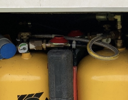

Just so your aware, there are different types of filler and it could be like this.
Yes that looks more like what I have (the black plastic box at the bottom of the attached picture). I also have a bag with 3 or 4 different brass attachments which I assume are for filling in different countries.

Just going by your photo you will obviously have to connect both bottles back up or you will only be filling one of them. (y)
Yes that’s it, the only difference being with this type ( I have same type) you have to screw adapter in for uk , where the larger type you don’t need an adapter for uk
Yes I removed the bottle earlier to exchange it for a full one before realising what I had.
Well spotted young man.
Have you got a bulkhead regulator or one fitted to the gas bottle. This is my set up with a regulator on each bottle. Just turn on what ever bottle you want to use.

Have you got a bulkhead regulator or one fitted to the gas bottle. This is my set up with a regulator on each bottle. Just turn on what ever bottle you want to use.View attachment 493049
I have one on the gas bottle like your set up. My second bottle is just a regular Calor gas bottle I guess it's in case the gas runs out and there's nowhere nearby to fill up.
Yes that’s it , you just have to just swap the regulator over to the calor bottle.
